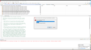

The connection is normal. The m4 kernel is displayed when am62x EVM is used. How can I solve the problem
    The BLAZAR_Cortex_M4F_0 core is used for HSM appimage. To run examples on M4F core, it is recommended to connect to BLAZAR_Cortex_M4F_1 core. If you want to initialize EVM with your HSM appimage you can do it using SBL. For running examples, please connect to BLAZAR_Cortex_M4F_1 core.

    May I know why you want to connect to BLAZAR_Cortex_M4F_0 ?
    Typically All Applications should load on BLAZAR_Cortex_M4F_1 core and BLAZAR_Cortex_M4F_0 is belongs to HSM ( Hardware Security Module ).
