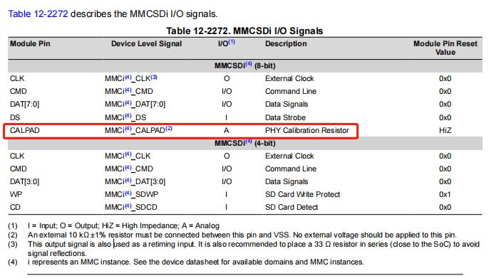

    Please avise the location for the PHY Caibration resistor in the design, we can't find it in the design;
    As i understand the PHY calpad has not been pinned out.
    Reference - Datasheet
    This only applies to the MMC0 port of AM64x.  It does not apply to the MMC0 port of AM62x and the future AM62X devices.
    The TRM is a generic diagram and refer datasheet for the availability of this pin.
    Sreenivasa
  • Hi, Kallikuppa,
    It fine for the PHY Caibration resistor issue, and I will start the new thread for RGMI and LVDS issues. thanks.
