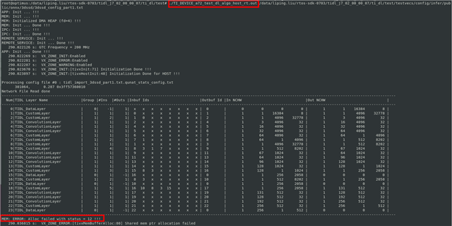

When running 3DSSD model inference on board, we encountered the following errors:
config file used:
The version of SDK is 0703, could you help me to solve this issue? Thank you.
  • Dear Liping,
         the returned error means “out of memory”, which represents the input image size for inference is too big or the model’s requirement on system memory is beyond the memory map of that SDK base.
    BR
    Sikai
