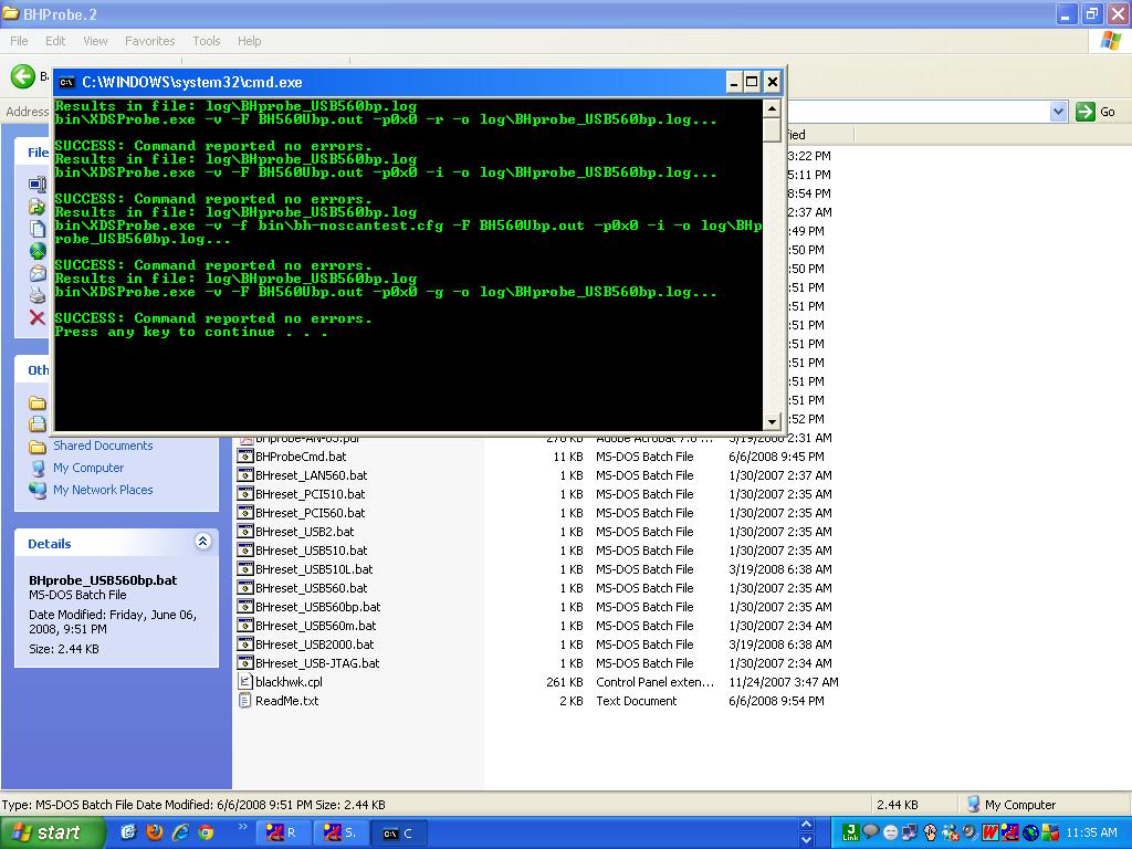

  • Hi All,
            We have developed Custom board using TMS320C6474. Whenever we try to connect DSP using Black Hawk 560bp Emulator(14 pins), Getting below error:
    Error connecting to the target:
    Error 0x80000244/-2131
    Fatal Error during: Register, Initialization, OCS,
    Cannot access register at 0x00000000
    We used BHprobe utility to trace problem, but its giving successful .
    I have attached for your reference.
    Its need some help immediately,
    Thanks & Regards,
    Thu 06/30/2011-11:28:02.46
    TEST 1 - RESET
      BHProbe 5.01: Blackhawk USB560bp JTAG Emulator
    Thu 06/30/2011-11:28:02.56
    bin\XDSProbe.exe -v -F BH560Ubp.out -p0x0 -r -o log\BHprobe_USB560bp.log

    TEST 2 - SCAN
    Thu 06/30/2011-11:28:03.89
    bin\XDSProbe.exe -v -F BH560Ubp.out -p0x0 -i -o log\BHprobe_USB560bp.log

    The JTAG DR Integrity scan-test has succeeded.
    Done.
