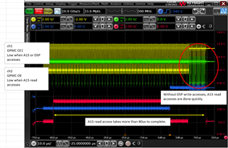

Scenario:
- Both Cortex-A15 and DSP are accessing to GPMC (same CS).
- A15 accesses are read, DSP accesses are write. A15 and DSP use single access.
- If both accesses occur simultaneously, A15 read accesses are interrupted by DSP write accesses.
One A15 access per 10 to 20 DSP accesses.
Waveform#1:
Waveform#2 (Zoom-up):
GPMC register configuration is attached.
GPMC_Regs.docx
Question:
I thought GPMC handles A15 and DSP accesses in a round-robin manner, but why DSP accesses are prioritized?

  • What is the A15 MMU setting for the page where the reads are going? Is it strongly ordered? This means the A15 will send one read, and wait for it to complete. If another core like C66x is doing 10-20 posted writes (not blocking on each write) they can all get queued ahead of the one by one reads. Looking quickly through the memory access registers like MPAX and MAR on C66x I don't see similar control as with A15.
    My first suggesting would be a readback scenario to throttle the C66x writes, so each after each write read back the value, that should throttle the C66x writes. If this seems to help it will confirm it is the scenario above that is happening.
      Pekka
  • Hi Pekka,
    Sorry for my late reply.
    Customer tried above suggestion and it worked!
