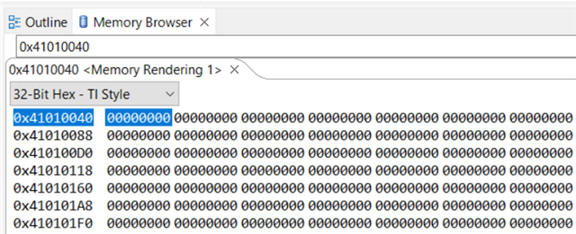

There is a R5F empty example under MCU SDK, how to run it?
I tried if not boot A53 Linux, connect CCS, download empty_am62x-sk_r5fss0-0_freertos_ti-arm-clang\Debug\empty_am62x-sk_r5fss0-0_freertos_ti-arm-clang.out
MAIN_Cortex_R5_0_0: GEL Output: ctl_int_status = 0x02000000...
MAIN_Cortex_R5_0_0: GEL Output: --->>> DDR Initialization completed... <<<---
MAIN_Cortex_R5_0_0: GEL Output: --->>> DDR4 Initialization is DONE! <<<---
MAIN_Cortex_R5_0_0: Trouble Writing Memory Block at 0x41010040 on Page 0 of Length 0x2210: (Error -1065 @ 0x0) Unable to access device memory. Verify that the memory address is in valid memory. If error persists, confirm configuration, power-cycle board, and/or try more reliable JTAG settings (e.g. lower TCLK). (Emulation package 9.8.0.00235)
MAIN_Cortex_R5_0_0: File Loader: Verification failed: Target failed to write 0x41010040
MAIN_Cortex_R5_0_0: GEL: File: C:\ti\workspace_v12\empty_am62x-sk_r5fss0-0_freertos_ti-arm-clang\Debug\empty_am62x-sk_r5fss0-0_freertos_ti-arm-clang.out: Load failed.
Address 0x41010040 can't be modified in Memory Browser also.

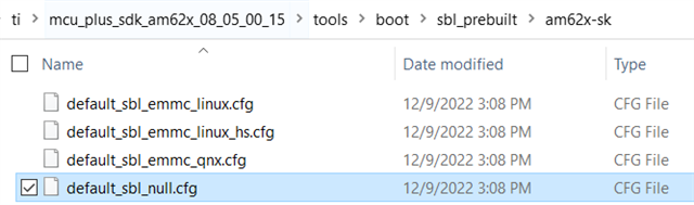

    C:\ti\mcu_plus_sdk_am62x_08_05_00_14>python uart_uniflash.py -p72 --cfg=sbl_prebuilt/am62x-sk/default_sbl_null.cfg
    python: can't open file 'C:\\ti\\mcu_plus_sdk_am62x_08_05_00_14\\uart_uniflash.py': [Errno 2] No such file or directory
    C:\ti\mcu_plus_sdk_am62x_08_05_00_14>cd tools
    C:\ti\mcu_plus_sdk_am62x_08_05_00_14\tools>cd boot
    C:\ti\mcu_plus_sdk_am62x_08_05_00_14\tools\boot>python uart_uniflash.py -p72 --cfg=sbl_prebuilt/am62x-sk/default_sbl_null.cfg
    Parsing config file ...
    Parsing config file ... ERROR. 2 error(s).
    [ERROR] Parsing error found on line 20 of sbl_prebuilt/am62x-sk/default_sbl_null.cfg
    [ERROR] File not found !!!
    [ERROR] Parsing error found on line 31 of sbl_prebuilt/am62x-sk/default_sbl_null.cfg

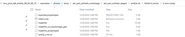

    There is not sbl_uart_uniflash_stage2.release.appimage file under C:\ti\mcu_plus_sdk_am62x_08_05_00_15\examples\drivers\boot\sbl_uart_uniflash_multistage\sbl_uart_uniflash_stage2\am62x-sk\r5fss0-0_nortos\ti-arm-clang

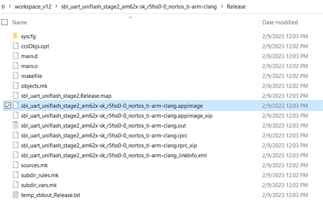

    Then I import the project into CCS and build, generated files as below:
    I copy it to C:\ti\mcu_plus_sdk_am62x_08_05_00_15\examples\drivers\boot\sbl_uart_uniflash_multistage\sbl_uart_uniflash_stage2\am62x-sk\r5fss0-0_nortos\ti-arm-clang  and rename sbl_uart_uniflash_stage2_am62x-sk_r5fss0-0_nortos_ti-arm-clang.appimage to sbl_uart_uniflash_stage2.release.appimage,

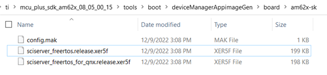

    in the file line 31:
    # DM image is flashed at 0x880000 or to whatever offset your bootloader is configured for
    --file=deviceManagerAppimageGen/board/am62x-sk/sciserver_freertos.release.appimage --operation=flash --flash-offset=0xA00000
    there is not such file under folder:

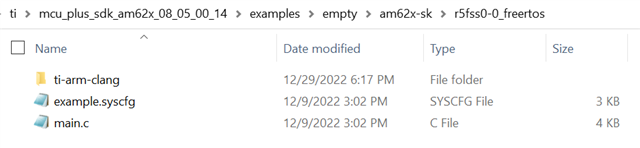

    Does it sdk need to be re-build before using? I can't build the sdk successfully:
    C:\ti\mcu_plus_sdk_am62x_08_05_00_14> gmake all report below error.
    Linking: am62x:r5fss0-0:nortos:ti-arm-clang sbl_ospi_linux_stage2.release.out ...
    C:/ti/ti-cgt-armllvm_2.1.2.LTS/bin/tiarmclang -Wl,--diag_suppress=10063 -Wl,--ram_model -Wl,--reread_libs -Wl,-iC:/ti/mcu_plus_sdk_am62x_08_05_00_14/source/kernel/nortos/lib -Wl,-iC:/ti/mcu_plus_sdk_am62x_08_05_00_14/source/drivers/lib -Wl,-iC:/ti/mcu_plus_sdk_am62x_08_05_00_14/source/board/lib -Wl,-iC:/ti/mcu_plus_sdk_am62x_08_05_00_14/source/drivers/device_manager/sciclient_direct/sbl/lib -Wl,-iC:/ti/mcu_plus_sdk_am62x_08_05_00_14/source/drivers/device_manager/rm_pm_hal/sbl/lib -Wl,-iC:/ti/ti-cgt-armllvm_2.1.2.LTS/lib -Wl,-m=sbl_ospi_linux_stage2.release.map -o sbl_ospi_linux_stage2.release.out obj/release/main.obj obj/release/ti_drivers_config.obj obj/release/ti_drivers_open_close.obj obj/release/ti_board_config.obj obj/release/ti_board_open_close.obj obj/release/ti_dpl_config.obj obj/release/ti_pinmux_config.obj obj/release/ti_power_clock_config.obj -lsciclient_direct_sbl.am62x.r5f.ti-arm-clang.release.lib -lrm_pm_hal_sbl.am62x.r5f.ti-arm-clang.release.lib -lnortos.am62x.r5f.ti-arm-clang.release.lib -ldrivers.am62x.r5f.ti-arm-clang.release.lib -lboard.am62x.r5f.ti-arm-clang.release.lib -llibc.a -llibsysbm.a linker.cmd
    tiarmclang: error: no such file or directory: 'obj/release/ti_drivers_config.obj'
    tiarmclang: error: no such file or directory: 'obj/release/ti_drivers_open_close.obj'
    tiarmclang: error: no such file or directory: 'obj/release/ti_board_config.obj'
    tiarmclang: error: no such file or directory: 'obj/release/ti_board_open_close.obj'
    tiarmclang: error: no such file or directory: 'obj/release/ti_dpl_config.obj'
    tiarmclang: error: no such file or directory: 'obj/release/ti_pinmux_config.obj'
    tiarmclang: error: no such file or directory: 'obj/release/ti_power_clock_config.obj'
    gmake[3]: *** [sbl_ospi_linux_stage2.release.out] Error 1
    gmake[3]: Leaving directory `C:/ti/mcu_plus_sdk_am62x_08_05_00_14/examples/drivers/boot/sbl_ospi_linux_multistage/sbl_ospi_linux_stage2/am62x-sk/r5fss0-0_nortos/ti-arm-clang'
    gmake[2]: *** [sbl_ospi_linux_stage2_am62x-sk_r5fss0-0_nortos_ti-arm-clang] Error 2
    gmake[2]: Leaving directory `C:/ti/mcu_plus_sdk_am62x_08_05_00_14'
    gmake[1]: *** [all] Error 2
    gmake[1]: Leaving directory `C:/ti/mcu_plus_sdk_am62x_08_05_00_14'
    gmake: *** [all] Error 2
  • Hi Tony,
    You can use command line to build the project. Please follow the below link for building example project via command line.
    https://software-dl.ti.com/mcu-plus-sdk/esd/AM62X/08_04_00_16/exports/docs/api_guide_am62x/MAKEFILE_BUILD_PAGE.html#MAKEFILE_EXAMPLE_BUILD
    In a nutshell, you can use below command to build the required 2nd stage bootloader:
    gmake -s -C .\examples\drivers\boot\sbl_uart_uniflash_multistage\sbl_uart_uniflash_stage2\am62x-sk\r5fss0-0_nortos\ti-arm-clang\ all
    However, building via CCS is also OK and you need not copy and rename the appimage. You can just update the path in default_sbl_null.cfg to wherever the appimage is located.
    We do not need to build whole SDK for DM. To build DM, I have responded in this thread https://e2e.ti.com/support/processors-group/processors/f/791/t/1194627
