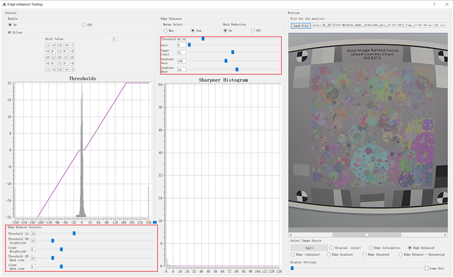

Hi all,
In the help documentation of EE plugin in DCC2.5, I can find the describe of how to use EE plugin and the meaning of the parameters in EE plugin, but I cannot figure out that how to tune this plugin specifically, is there a guide describes what or how value and level of these parameters (as shown in red rectangle in below screenshot) need to be tuned to?
And how to understand the plot of "Thresholds" and "Sharper Histogram"?
Thanks.
  • Hi Zhili,
    Tuning tool is under NDA and therefore I cannot discuss the details publicly.
    You may find those EE details in TDA4 TRM.
    The plots are for simple visualization of data and they are not critical.
    Basically, you may get an input image with many edges (e.g., resolution chart or other scenes with details) and change the controls on the GUI so that the output image is sharp and not too noisy (higher thresholds gives lower noise in general).
