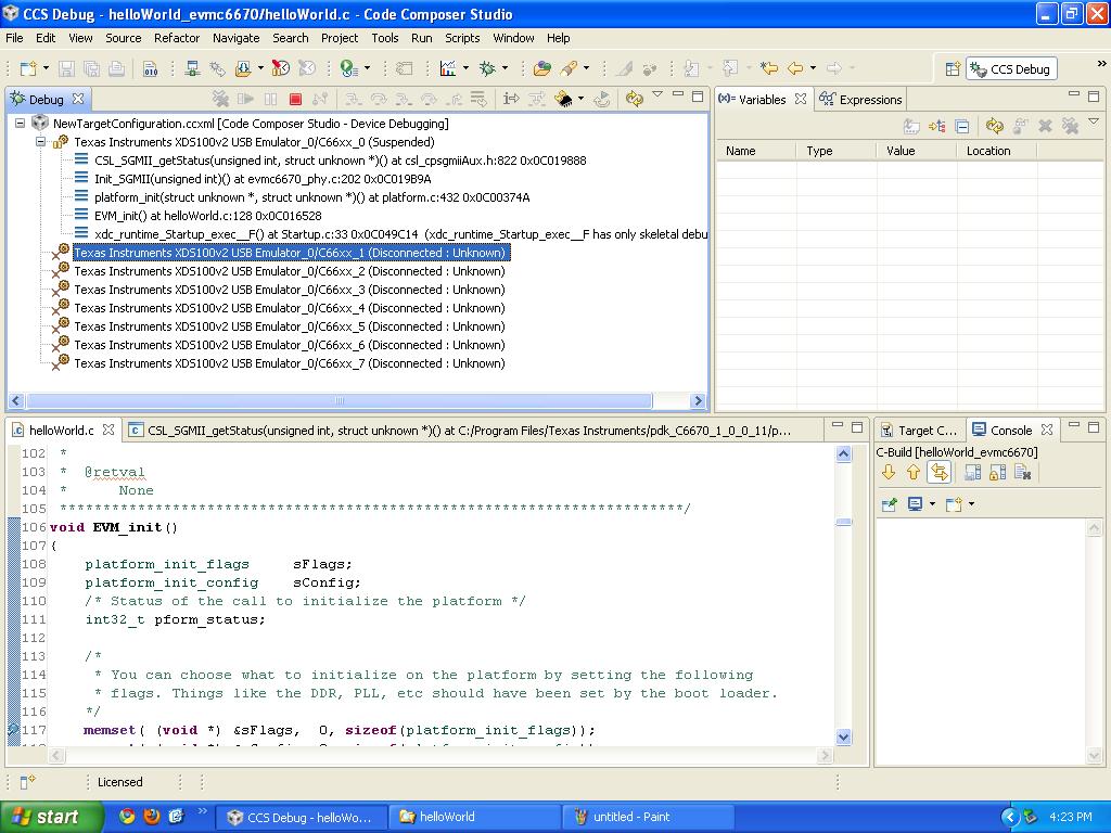

I compiled the helloWorld application under C:\Program Files\Texas Instruments\mcsdk_2_00_00_11\examples\ndk\helloWorld\evmc6670l.
On running the helloWorld NDK application on TCI6618 EVM having Dual PHY, its observed that Init_SGMII() function doesnt exit, and keeping running in a loop as shown in the attachment. I believe that this application is meant for TCI6618 EVM Lite version, which will not work for the Dual PHY version EVM. is it true ?
Has anyone tested the helloWorld NDK application for TCI6618 EVM with Dual PHY ?

Arun,
THere was this same issue with MCSDK 1.0 too for c6474 for Dual PHY.
The FIX for CCSv4 HelloWorld project for running the NDK2.2 (From MCSDK 1.0) on the dual Faraday EVM was uploaded at :
http://processors.wiki.ti.com/images/0/05/NDK2_2_dual_evm6474.zip
I believe this same could be the case for MCSDK 2.0 too for c66x for CCSv5 HelloWorld Project.
Are you or anyone aware of such a kinda problem ? Pls help.
Santosh
