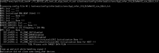

When we ran the TI_DEVICE_a72_test_dl_algo_host_rt.out with a 16bit model on the EVM(it has been infered and passed on the PC),
the program got stuck like the figure shown below, and we have to manually terminate it after a long-time wait.

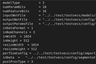

The parameters written in the import configuration file are shown in the figure below:
Questions:
1. Why is the model inference passed on the PC, but the result cannot be inferenced on the EVM?
2. Could you please take a look at our config file attached above, do we miss any parameters that cause this program-stuck problem?
3. Which parameters should be included in a config file if I want to import the model into 16bit?
Look forward to your reply!

        The following is the relevant log, please check.
    root@j7-evm:/opt/tidl_test# ./TI_DEVICE_a72_test_dl_algo_host_rt.out s:testvecs/config/infer/public/onnx/byd_infer_lfd_BiSeNetV2_sim_16bit.txt
    Processing config file #0 : testvecs/config/infer/public/onnx/byd_infer_lfd_BiSeNetV2_sim_16bit.txt

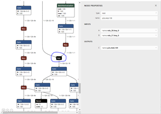

    I noticed your model has an eltwise layer that does vector and tensor additon (picture of layer attached) which is not supported by our TIDL runtime. I would suggest using our Open Source RunTime (OSRT) offering. Please refer to the following repo link:
    github.com/.../edgeai-tidl-tools
    Your model looks like it is using the ONNX v8 format while our OSRT supports ONNX v7 format. You might have to re-export the model to get things working properly (in addition to the above fix).
    Let me know if you face any further issues.

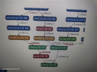

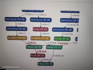

        By the way, I also want to know the reason for the following problem: If the add layer is not supported, then why the model board side reasoning passed at 8bit?
        Kong
    I highly doubt it was functionally passing. By the looks of it, TIDL interpreted that layer's output as a vector and possibly did an eltwise of a single vector from the tensor with the other vector instead of tensor-vector eltwise. I'm attaching the extract of the layer in your model as well as what TIDL interpreted below. Like I said earlier, we do not support vector-tensor eltwise in our standalone TIDL runtime.

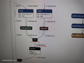

         So what is the workaround of this case?  Do we need to explicity broadcast the vector to a tensor and then feed it into EltWise layer?  We also notice that there is a EltWise layer, which the output is as we expected.  Why does the vertor-tensor Elt work here?  Does it do the same thing as multiplying the tensor by a constant, keeping the same tensor?
         Kong
        The screenshot of the model is here, please check, thank you!
  • Hi Kong,
    Since we don't support vector-tensor eltwise, the model import is resulting into some indeterminate state where it assumes either vector-vector or tensor-tensor input and proceeds accordingly. In either case, the output of the layer will not functionally match according to your expectation since our TIDL runtime assumes that the inputs of eltwise are of the same dimension.
    That being said, to get things working, you can do one of the following:
    1. Run your model using our OSRT (mentioned earlier).
    2. Rexport the model with the vector broadcasted as a tensor. In this case, you could still run using TIDL-RT.
    Aaron
