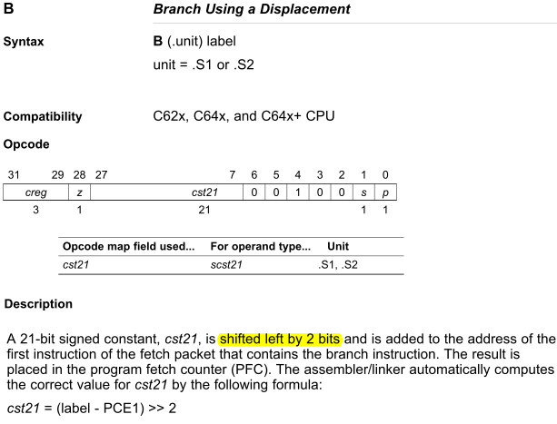

I would like to ask some questions on the writing of an ISFP (Interrupt Service Fetch Packet). By "versatile" I mean the ISFP uses register branch the range is not restricted to a constant displacement. All questions revolve around an example 6455 Starter Project.zip which Brad Griffis posted on 10-19-2009.

Note that I did it "lazy" in this code and just used a relative branch.  The "proper" way would be to push a register, move the complete address into the register, branch to that address, pop original contents during delay slots.  The "lazy" way will work as long as the table and ISR are both in the internal RAM (4 MB reach?)

Question I:
Branch using a displacement has a 21 bit constant, which will be shifted left by 2 bits to generate the address. Therefore, it should be 23 bits address, 2^23=8MB, not 4MB.

  • 1) Signed 21 bits with a left shift of 2 gives a total range of 8MB, or a reach of +/-4MB.
