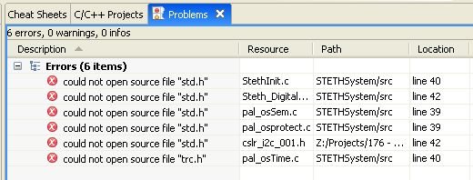

    I have gone through and deleted out what i had for code ( i had both the V_09 that may have been for the 5505 and the V_12 for the 5515)  and reloaded my code for the V_12from the above link.  Now, when i get into Code Composer and tried to build and debug the program, it tells me that there are errors because the std.h and trc.h files can not be opened.  I have looked and they are #includes for these in several subprograms, but they do not exist in the files that i down loaded.  Do you have an idea why not?
    Does anyone have these files?
  • This should be in Bios packages\ti\bios\include. Check your Bios setup.
    Regards.
  • I see them there.  I will give that a try.
