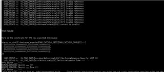

Hello.
When loading SD kernel on A72, prepared to be executed for Vision_apps (SDK 8.5) using SBL and while one App is running in MCU1_0, I receive a temprary error (Arago finally is executed but is taking around 2 minutes to be loaded) that I don't know how to solve:
This is the info when Arago is executed and I gan to log in:
How can I solve this issue and speed up Arago run?
    May I know what is the procedure you are following to load vision_apps using SBL?
    Nikhil
  • This iwaiting s happening before load vision_apps. System is booting from SD card, using SBL compiled for HLOs ("make sbl_mmcsd_img_hlos") and prepared one app multiimage with CAN_profile to be running in MC1_0. DTB in linux rootfs is changed to disable MCAN_0 and MCU_UART avoiding conflicts.
    With all changes applied, CAN_profile (lighly adapted and recompiled) works without issues,
    Arago is finally executed (after 2 minutes), and I can launch "source ./vision_apps_init.sh":
    And after launcheing some vision apps, I get segmetation faults (not present when I use SPL booting):
    BR

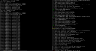

    From the screenshot shared for the logs of "./vision_apps_init.sh", I see that the MCU2_0 and MCU2_1 logs are waiting for HLOS to be ready and is stuck there.
    This could be the reason why you are seeing the errors while running the application.
    Could you confirm if you have integrated vision_apps dts changes and rtos_memory_map changes in Linux with the common proc board dtsi file?
    Since I believe we use only common-proc-board.dtb file here, these changes should be present.
    Also, regarding your usecase, is it possible to use the combined_appimage tool in SBL instead of the boot app?
    If you are not looking for an early can response, I would suggest you use the combined_appimage tool instead of the boot app.

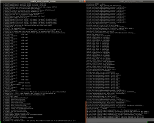

  • Hello Nikhil,
    Here is Pablo's last update as he could create combined_image optimized with SBL in debug mode. It looks like his path was not correctly handled for make. Then he copied DTB to same path on combined_image make is. This DTB is the one is created with patch when u-boot built (done this morning).
    After that, combined image is created (parsing 5 files as expected), and after copying to SD card, SBL is loading all properly. In this scenario, time is longer because of loading kernel image is done by SBL. But this is acceptable for the customer.
    However he observed that kernel is stuck at 2.524527s.
    (attached log files UART0_MAIN_ttyUSB2_115200.log and UART_MCU_ttyUSB1_115200.log)
    CAN_profile remains active.
    Pointing to DTB_IMG provided in SDK (base-board.dtb), also copied to same path,
    I observe crashing MCU1_0 CAN_profile (that has sense as the dts has no patch applied, then MCU UART and MCAN is referred in DTB and when used by A72 crashes can_profile). On the other hand, kenel panic appears in A72 because rootfs is not mounted.
    (attached logs: UART0_MAIN_ttyUSB2_115200_base_board_dtb.log & UART_MCU_ttyUSB1_115200_base_board_dtb.log)
    I guess behavior would be better if MCU1_0 image would have  changes/patches that are needed and suggested in post https://e2e.ti.com/support/processors-group/processors/f/processors-forum/1003429/faq-tda4vm-mcusw-demo-on-can-along-side-linux-on-a72 to be provided by TI for 8.5.
    Could you advise on how to go ahead on optimized solution?

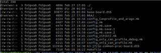

  • Hello, here are some clarifications, sorry for not be clear enough:
    DTB pointed ton DTB_IMG is not the one created this morning after applying linux patch to U-boot's DTS. The dtb used is the one compiled for linux ("make linux-dtbs"), and located in "ti-processor-sdk-linux-j7-evm-08_05_00_08/board-support/linux-5.10.153+gitAUTOINC+90c3a58fd2-g90c3a58fd2/arch/arm64/boot/dts/ti". Sorry for my mistake
    We have internally chatted and we realized that this restriction is not assumable. We must use a solution with SPL-UBOT in combined_image, so that, development in HLOS_BOOT. Thus, we should solve issue observed in:
