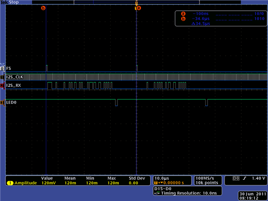

C5515 I2s DMA missing frames that are close in time
I have the i2s slave configured for ping pong DMA and interrupt driven operation. (see attached files).
The C5515 usb stick hardware is connected to an external sensor device that sends frames of data every 34.4 usec  The incoming clock rate from the external sensor is 2.5 MHz. i2s transfers 64 bits for stereo and DSP format  (32 bits for left + 32 bits right)
I have instrumented an LED on the board to indicate when the DMA interrupt gets serviced. There is a measure latency of 1 usec after the last bit sent by the sensor and 26 usec after the frame sync. The second frame sync comes in 10 usec after I've serviced the interrupt and I don't get a DMA for the next frame. Instead, I only get data from Frame 1.  Every DMA transfer gets frame 1 values and I don't see the interrupt service routine getting called after the frame 2 has been received.
Why don't I get frame #2 values?
I have the sensor configured to repeat the same pattern every two frames. Frame 1 contains 0xF080 1234 5678 9ABC, Frame 2 contains 0x0040 AAAA 5555 AAAA
WHen I look at the I2s registers I can see both patterns being updated in the registers. WHen I run the code I can see that the DMA controller is in fact setting the ping and pong bits.

  • Here's up update on this issue. I stil don't have a fix for the DMA, but I do have it working with the interrupt mode of operation. I've attached the source code for using the i2s slave in interrupt mode of operation without DMA's. With this code I don't miss any frame syncs and I don't get any overruns.
    The screen shot below shows the transfers. For the DMA mode of operation I do no get the second LED0 pulse.  Why??
    Any tips for figuring out why the DMA is not working correctly?
