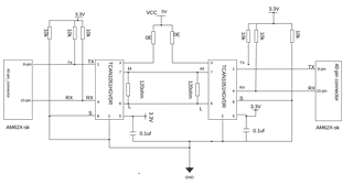

    I had build the overlay file, and copied the k3-am62x-sk-mcan.dtbo file into /root/boot.
    but when i tried to send data using cansend command the CAN bus goes to off state.
    i had setup two am62x sk board with two CAN transceivers.One act as Transmitter and the other act as Receiver.

    Kindly find the connection diagram below.

  • Murali,
    Please confirm that you also have pin 2 of the TCAN1051 connected to ground, and that you have the recommended 0.1uF decoupling capacitor between VCC and GND near the TCAN1051 XCVR.
    The other issue I see is that you have the pin 8 silent pin pulled high. This puts the transceiver in silent mode, meaning that the transmitter is disabled. This will definitely cause a bus-off state.
    Stuart
  • Hi Stuart,
    Thanks for the reply, kindly find my response in blue below,
    the TCAN1051 XCVR.
    Yes, we have connected pin 2 to ground and have a 0.uf capacitor between VCC and Gnd.
    Yes, we have gone through the Datasheet and connected Pin 8 to ground, so that the transceiver will be in Normal mode.(Both Transmitter and Receiver Works).
    But still we can't able to get the output, we are still facing the same issue.
    Kindly find the updated block diagram for your reference.
    Murali C

    Also, I observed that after connecting my module with J24, voltage gets drop to 1.1 V from 3.3 V. To cross check if module is faulty, I tried same setting with a different board, there is no voltage drop in that case, also CAN is working fine there.

    One problem you have is the power to the CAN transceiver: 'J24, voltage gets drop to 1.1 V from 3.3 V'. The CAN transceiver will not work with <2v VCC. Please get a reliable 3.3V or 5V and test again.
    regards,
