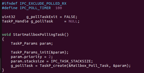

    but still same error is coming "error: identifier "Mailbox_Poll_Task" is undefined"
    "C:/work/workspace/ACP-8.8.7_S32G399_GHS_21203_ti/Tresos/plugins/McalExt_TS_T31D46M1I0R0/MCAL_Delivery/mcal/CddIpc/ipc_baremetal_hw/src/ipc_mailbox.c", line 122: error: identifier "Mailbox_Poll_Task" is undefined
    "C:/work/workspace/ACP-8.8.7_S32G399_GHS_21203_ti/Tresos/plugins/McalExt_TS_T31D46M1I0R0/MCAL_Delivery/mcal/CddIpc/ipc_baremetal_hw/src/ipc_mailbox.c", line 443: error: type name is not allowed
    "C:/work/workspace/ACP-8.8.7_S32G399_GHS_21203_ti/Tresos/plugins/McalExt_TS_T31D46M1I0R0/MCAL_Delivery/mcal/CddIpc/ipc_baremetal_hw/src/ipc_mailbox.c", line 443: error: expected a ";"
    "C:/work/workspace/ACP-8.8.7_S32G399_GHS_21203_ti/Tresos/plugins/McalExt_TS_T31D46M1I0R0/MCAL_Delivery/mcal/CddIpc/ipc_baremetal_hw/src/ipc_mailbox.c", line 443: error: identifier "n" is undefined
    4 errors detected in the compilation of "C:/work/workspace/ACP-8.8.7_S32G399_GHS_21203_ti/Tresos/plugins/McalExt_TS_T31D46M1I0R0/MCAL_Delivery/mcal/CddIpc/ipc_baremetal_hw/src/ipc_mailbox.c".

  • Hello Pradeep,
    Please remove this path pdk_jacinto_08_05_00_36/packages/ti/drv/ipc/ from include folder which I told you earlier.
    $(McalExt_CORE_PATH)/MCAL_Delivery/mcal/ path is in your include list right ? if not please add this path.
    I think i found the problem here,
    We have defined IPC_EXCLUED_POLLED_RX as part of our makefile, that is the reason we aren't getting the issue while compilation.
    Include all the definitions which are present in our make file also in yours , then you will not face the issue.
    This function is being used for " ifndef  IPC_EXCLUED_POLLED_RX "
    Remaining errors i think are due to declaration of "uint32 n " in the for loop. Can you check it by declaring it the above along with other variables in API ?
    I hope these will fix your issues pradeep.
