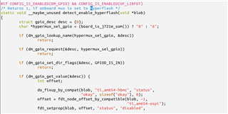

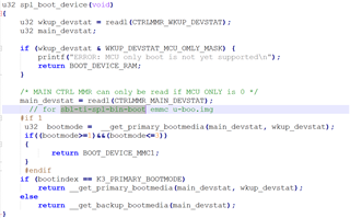

         Now I change the u32 spl_boot_device(void) in arch/arm/mach-k3/j721e_init.c as follows:
        721 u32 spl_boot_device(void)
    722 {
    723 u32 wkup_devstat = readl(CTRLMMR_WKUP_DEVSTAT);
    724 u32 main_devstat;
    725
    726 if (wkup_devstat & WKUP_DEVSTAT_MCU_OMLY_MASK) {
    727 printf("ERROR: MCU only boot is not yet supported\n");
    728 return BOOT_DEVICE_RAM;
    729 }
    730
    731 /* MAIN CTRL MMR can only be read if MCU ONLY is 0 */
    732 main_devstat = readl(CTRLMMR_MAIN_DEVSTAT);
    733 // for sbl-ti-spl-bin-boot emmc u-boo.img
    734 #if 1
    735 u32 bootmode = __get_primary_bootmedia(main_devstat, wkup_devstat);
    736 if((bootmode>=1)&&(bootmode<=3))
    737 {
    738 return BOOT_DEVICE_MMC1;
    739 }
    740 #endif
    741 if (bootindex == K3_PRIMARY_BOOTMODE)
    742 return __get_primary_bootmedia(main_devstat, wkup_devstat);
    743 else
    744 return __get_backup_bootmedia(main_devstat);
    745 }
    And the boot device change to MMC1 but still could not jump to the u-boot.img. The log is:

    So even the SBL is booting from eMMC? Can you please comment on what is the boot media that you are using? Why are you required to make the code change for MMC1?
    Also have you migrated your code from SDK 7 to the latest?
    Keerthy
  • Dear Expert,
    1. My u-boot.image is put in the eMMC。
    2. In order to boot MCU10 quickely, my boot sequence is: SBL-->Boot MCU10 --> Boot App in MCU10 loads and runs u-boot-spl which is loacted at ospi_flash -->u-boot-spl loads and runs u-boot.img which is loacted at eMMC.
    3. Now it seems that the BootAPP loads and runs the u-boot-spl successfully but the u-boot-spl loads and runs u-boot.img failed.

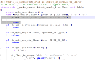

    4. I add some tracing log to ti-processor-sdk-linux-j7-evm-08_05_00_08\board-support\u-boot-2021.01+gitAUTOINC+7996ed51f1-g7996ed51f1\common\spl\spl_fit.c and the log is as follows.

    board_init_r spl_boot_list[0]=0x11, spl_boot_list[1]=0xdeadbeef, spl_boot_list[2]=0xdeadbeef
    boot_from_devices loader->boot_device=0x11 loader->load_image=0x8008334c
    Trying to boot from MMC1
    spl_load_image MMC1, loader->boot_device=0x11, spl_image->name=
    spl_image->load_addr=0x0 spl_image->entry_point=0x0 spl_image->boot_device=0xdeadbeef spl_image->size=0
    spl_mmc_load filename=u-boot.img raw_part=0x0 raw_sect=0x1400 bootdev->boot_device=0x11
    spl_mmc_load boot_mode=0x3
    spl_mmc_load part=0x1
    spl_mmc_load err1=0x0
    spl_mmc_load mmc boot mode: raw
    spl_mmc_load raw_sect=0x1400
    mmc_load_image_raw_sector sector=0x1400
    mmc_load_image_raw_sector count=0x1400
    mmc_load_image_raw_sector image_get_magic=0xd00dfeed
    spl_load_simple_fit sector=0x1400
    spl_load_simple_fit fit read sector 1400, sectors=4, dst=807ff6c0, count=4, size=0x708
    spl_load_simple_fit images=88spl_load_simple_fit node=100spl_load_fit_image sector=5120, base_offset=1800 node=100
    spl_load_fit_image step=1
    spl_load_fit_image step=2
    spl_load_fit_image step=3
    spl_load_fit_image step=4
    spl_load_fit_image step=5
    spl_load_fit_image step=6
    External data: dst=70000000, offset=708, size=9bf0
    spl_load_fit_image end
    spl_load_simple_fit Image OS is ARM Trusted Firmware
    spl_load_simple_fit spl_image->os=25spl_load_simple_fit spl_fit_get_image_node node=312 images=88
    spl_load_fit_image sector=5120, base_offset=1800 node=312
    External data: dst=9e800000, offset=a2f8, size=5e6d0
    spl_load_simple_fit spl_fit_get_image_node ret=0
    spl_load_simple_fit Loadable111111 is Trusted Execution Environment
    spl_load_simple_fit spl_fit_image_get_os os_type=26
    spl_load_simple_fit spl_fit_get_image_node node=480 images=88
    spl_load_fit_image sector=5120, base_offset=1800 node=480
    External data: dst=a0000000, offset=689c8, size=2fe28
    spl_load_simple_fit Loadable111111 is Unknown OS
    spl_load_simple_fit spl_fit_image_get_os os_type=255
    spl_load_simple_fit spl_fit_get_image_node node=660 images=88
    spl_load_fit_image sector=5120, base_offset=1800 node=660
    5. Attachment is the spl_fit.c traced

    Seems like some un-initialized module is being accessed and that is causing a crash. Can you use debugger to check where the crash happens?
    Try disabling PCIe, USB, networking nodes from DT.

    This seems to suggest that you are booting the u-boot-spl from eMMC aka MMC1. What is in the OSPI flash? To begin with what's the boot mode that you use to boot SBL?
    Keerthy
  • Dear Expert,
        I have transformed u-boot-spl.bin to u-boot-spl.appimage which is located in the ospiflash and loaded by MCU10_APP. Then the u-boot.img is located in the emmc.
        I used the OSPIFLash to boot my SBL.
    That will definitely cause issues. The boot mode you have set is OSPI. So SBL & U-Boot-SPL are coming up correctly as the boot mode is OSPI and the
    binaries are in OSPI. The U-Boo.img is located in eMMC. I fail to understand how you are getting the prints below:
    As you are booting the u-boot-spl from the OPSI and not from MMC1(eMMC). Is that a code change that you have done?
    - Keerthy

    Can you disable the flash node?
    By default this node is disabled. Do you need this in U-Boot?
    I believe the above code is detecting hyperflash. Can you delete that function?
    - Keerthy
  • Yes , I have chang the code in j721e_init.c:
  • I believe the above code is detecting hyperflash. Can you delete that function?
    Please try to remove probing the hyperflash which is most likely not present on your board.
    Keerthy
  • Hi, which files should i disable it?
  • Hi,Keerthy
        I disbale the config but it doesn't work.
       Only could I return directly then i works.
  • Please add return directly. I believe you should now be coming to U-Boot prompt. This is not needed as you do NOT have the part on your board.

  • Dear expert,
        Thank you. There seems some drivers error with the default SDK and I patch it with my driver. Now it works.
