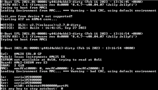

  • Hi Hong,
    A1. MMC/eMMC port is determined by BOOTMODE pins, and from which eMMC partition (boot1/boot2/UDA) R5-SPL boots from is solely by eMMC EXTCSD[179]
    I have conducted 4 "experiments" to understand more about the eMMC boot process. Can you help explain these 4 experiments because the results are conflicting with what you said. From the results, it seems like if the switches are set to eMMC boot (not UDA), the mmc partconf determines the R5 SPL boot. On the other hand, if the switches are set to eMMC UDA, the R5 SPL is determined by the switch and the rest are determined by mmc partconf.
    Experiment 1
    BOOTMODE switch -> MMCSD boot (eMMC UDA raw)
    mmc partconf 0 1 1 1 (boot partition #1)
    UDA contain boot binary files
    Boot partition #1 empty
    -> stuck at R5 SPL boot
    Experiment 2
    UDA contain boot binary files built at 13:36
    Boot partition #1 contain boot binary files built at 13:16
    -> R5 SPL boot from UDA and the rest boot from boot partition #1. The first SPL shows 13:36 which is from UDA. The second SPL and u-boot shows 13:16 which is from boot partition #1. I built two different boot binary files (tiboot3.bin, tispl.bin, u-boot.img) separately at different times and flashed them individually.
    Experiment 3
    BOOTMODE switch -> eMMC boot
    mmc partconf 0 1 7 1 (UDA)
    UDA empty
    -> nothing happens when I power on the board.
    Experiment 4
    Let me explain what does the experiment mean
    Eg. experiment 1
    I set the BOOTMODE switch on the board to boot from eMMC UDA raw mode. But in uboot I have preconfigure the EXT_CSD[179] to boot from boot partition #1. Then I flashed the boot files into UDA and leave boot partition #1 empty. Thus, the result is the console shows only the first SPL boot and stuck there.
  • Hello Chee,
    Thanks for running various test cases on your setup.
    From one of your tests, i.e., #2 booting up to u-boot prompt, can you capture "md.l 0x43000030 1"?
    -Hong
  • Hi Hong,
    This is the output for the command.
    => md.l 0x43000030 1
    43000030: 000000c3                               ....
    Can you tell me what actually happened in those tests that I ran above, especially in test #2. Can you also breakdown the boot process? Thanks.
