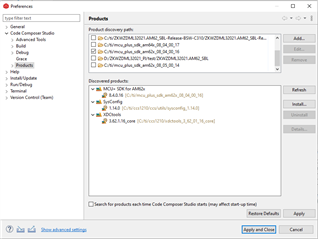

Product discovery path and Discevered product i'm using :
Next, I'm build, debug and load program (.out file) empty example (R5fss0-0-freertos).

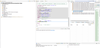

I believe JTAG has no problem because I tested empty example (R5) mcu_plus_sdk_am62x_08_04_00_16.Program run and print "All tests have passed!!".
Some images I use SDK 8.4 to run for core R5
So what is my problem or do you have any solution for me? And why ti sdk 8.5, no nonrtos example for core r5?
