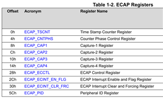

For eCAP, we accidentally found some mismatches between TRM (Revision from March 2022) and the implementation in the 8.05 SDK/PDK
This is the description in the TRM:
And these are the #defines for the register addresses from cslr_ecap.h:

The names do not always match (REVID vs. PID), and registers defined as 32bit in the TRM are defined as 16bit in the header.
This is a problem for the safety related software we are developing. When we use the definitions in our code, we need to be able to trace the names to the design, which would be in this case the TRM.
But here it is not obvious that e.g. ECAP_ECINT_EN_FLG is the same as ECAP_ECEINT + ECAP_ECFLG.

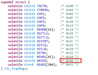

The same issue is with the struct definition in the same file. However here seems to be am additional bug in the code (I've added the address offsets as comments):
The size of the RSVD1 - arrays is wrong (should be 40, not 41), the current value leads to a wrong and unaligned address for the PID resp. REVID register.
