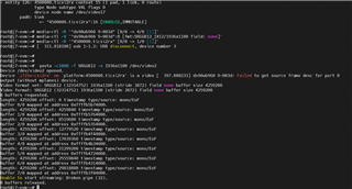

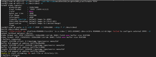

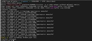

  • Hi
      I DIDN'T USE RTOS-SDK, ONLY LINUX-SDK 8.05, FOLLOWING THE CONNECTION YOU GAVE, I GENERATED 32 VIDEO NODES AFTER EXECUTION, BUT I USED "YAVTA -C1000 -F SRGGB12 -s 1936x1100 /dev/video2."
    "Command, the following problems occur, how can I solve the following?
    In the screenshot, I see you have given format as UYVY instead of SRGGB12 in yavta command.
    Do you mean you are seeing  the same error when you set format to SRGGB12?
    Could you please share me the full logs of "media-ctl -p" and the log from yavta command with SRGGB12 format?

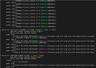

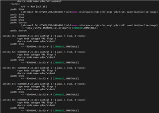

    media-ctl -p
    SRGGB12 format
    The above hardware environment is not based on DB960, but only masks the DB960 code about I2C.
    Sorry, didn't understand your usecase here. Could you please elaborate this?
    You have used the overlays of IMX390 camera right? Could you provide a flowchart on how your setup is?
    Also, could you please share the logs(including linux boot logs) in a text file (not screenshot)?

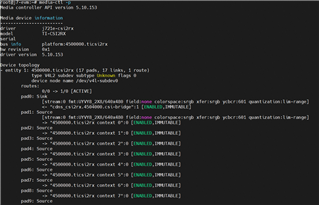

  • Hi Nikhil
      I'm sorry, the description was not clear before, I hope I can describe the basic information clearly this time.
       This is the data link we want to implement。
    Implementation scenario:We want to take out the power settings and register operations of the IMX390 based on the IMX390 Sensor Dirver, leaving only a Medio registration framework, and then access the 9296 based on this framework, and finally access the 9295 with the 9296.
    1、Modifying the device tree to load the IMX390 driver without power settings and register operations allows the creation of 32 videoX nodes.
    2、Directly use the i2c-tool to configure the link for the deserializer and serializer, which we have verified is up
    3、Use the command "yavta -n 3 -c10 -f UYVY -s 1920x1080 --skip 7 -F /dev/video2" to verify that there is no data flow
    Below is the startup log.

    Below is the command "media-ctl -p" information
    Media controller API version 5.10.153
    Media device information
    driver          j721e-csi2rx
    model           TI-CSI2RX
    serial
    bus info        platform:4500000.ticsi2rx
    hw revision     0x1
    driver version  5.10.153
    Device topology
    - entity 1: 4500000.ticsi2rx (17 pads, 17 links, 1 route)
                type V4L2 subdev subtype Unknown flags 0
                device node name /dev/v4l-subdev0
    	routes:
    		0/0 -> 1/0 [ACTIVE]
    	pad0: Sink
    		[stream:0 fmt:UYVY8_2X8/640x480 field:none colorspace:srgb xfer:srgb ycbcr:601 quantization:lim-range]
    		<- "cdns_csi2rx.4504000.csi-bridge":1 [ENABLED,IMMUTABLE]
    	pad1: Source
    		-> "4500000.ticsi2rx context 0":0 [ENABLED,IMMUTABLE]
    	pad2: Source
    		-> "4500000.ticsi2rx context 1":0 [ENABLED,IMMUTABLE]
    	pad3: Source
    		-> "4500000.ticsi2rx context 2":0 [ENABLED,IMMUTABLE]
    	pad4: Source
    		-> "4500000.ticsi2rx context 3":0 [ENABLED,IMMUTABLE]
    	pad5: Source
    		-> "4500000.ticsi2rx context 4":0 [ENABLED,IMMUTABLE]
    	pad6: Source
    		-> "4500000.ticsi2rx context 5":0 [ENABLED,IMMUTABLE]
    	pad7: Source
    		-> "4500000.ticsi2rx context 6":0 [ENABLED,IMMUTABLE]
    	pad8: Source
    		-> "4500000.ticsi2rx context 7":0 [ENABLED,IMMUTABLE]
    	pad9: Source
    		-> "4500000.ticsi2rx context 8":0 [ENABLED,IMMUTABLE]
    	pad10: Source
    		-> "4500000.ticsi2rx context 9":0 [ENABLED,IMMUTABLE]
    	pad11: Source
    		-> "4500000.ticsi2rx context 10":0 [ENABLED,IMMUTABLE]
    	pad12: Source
    		-> "4500000.ticsi2rx context 11":0 [ENABLED,IMMUTABLE]
    	pad13: Source
    		-> "4500000.ticsi2rx context 12":0 [ENABLED,IMMUTABLE]
    	pad14: Source
    		-> "4500000.ticsi2rx context 13":0 [ENABLED,IMMUTABLE]
    	pad15: Source
    		-> "4500000.ticsi2rx context 14":0 [ENABLED,IMMUTABLE]
    	pad16: Source
    		-> "4500000.ticsi2rx context 15":0 [ENABLED,IMMUTABLE]
    - entity 19: cdns_csi2rx.4504000.csi-bridge (5 pads, 2 links, 0 route)
                 device node name /dev/v4l-subdev1
    	pad0: Sink

    With Yavta verification, the following issues occur。
    Very sincerely ask you, what is the problem caused by this, I have looked at the source code, and I have not found a solution.

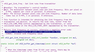

  • This is the meaning of the final error reported by the source code
    “-ENOENT: Link frequency or pixel rate control not found”
  • Hi Wei,
    Is 9295 - 9296 Maxim GMSL devices? Or are they some other FPD-Link devices?
    If it is a GMSL device, I checked internally regarding the same and currently there is no support for GMSL device on TI Linux SDK.
    You would have to refer the ser-des implementation of the FPD-Link device (UB953 - UB960) and see how it is connected via the device tree and implement the same for the GMSL device.
    Nikhil
