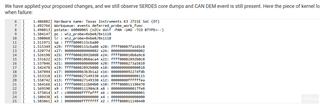

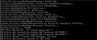

    1) Having SBL HLOS in optimized mode (with the patch applied) and dts changed:
    CAN profile app and Arago runs for a while, then CAN profile app reports CAN DEM and stops. (This happens every time). Pablo can provide the logs later to that you can point us how to solve the problem.
    2) We need a way to run SBL HLOS development, as we need early CAN for our application. Could you please point us to what changes are needed?
    Many thanks in advance,

  • Hello Nikhil.
    Monica says that CAN DEM is happening every time, but is not. Sometimes happens, but I don't have log for that. As soon as it happens I will attach to the post.
    Besides that, Arago most of the tries gets stuck in remote proc (not clear if is a timing occurrence or is happing because of specific operations on kernel load). We have done tries in 3 different setups, creating in each setup all binaries needed (SBL, patching, CAN profile, DTB, multi-image, etc) and we observed the same behavior in all of them. We don't have a clear statistic, but we assume that in around 90% of PowerOff-PowerON tests, A72 is stuck in remoteproc operations (before the stopping point failure "-22" is observed instead of result of "-2" in remote proc operations when is not stuck)
    (*) attached complete log for MCU and A72 in booting
    7144.remote_proc_A72_stuck.zip

    We tried your patch and now the booting is fine. Here we have some questions, and to bring some context I will try to briefly explain the steps that we are doing (from a clean SDK v8.5).
    8272.Patches_applied.zip
    1. In the linux kernel source base path (board-support/linux-5.10.153+gitAUTOINC+90c3a58fd2-g90c3a58fd2) we apply the following patches:
        - Linux_changes.patch
        - 1616.0001_2D00_vision_5F00_apps_2D00_Integrated.patch
       The only conflict with these two paths are the bootargs line in k3-j721e-common-proc-board.dts (line 17), which we resolve as:
         `bootargs = "console=ttyS2,115200n8 earlycon=ns16550a,mmio32,0x02800000 root=/dev/mmcblk1p2 ew rootfstype=ext4 rootwait";`

  • Hello Nikhil,
    We have applied your proposed changes, and we still observe SERDES core dumps and CAN DEM event is still present. Here the piece of kernel log when failure:

    [    1.542470] x19: ffff00082892b080 x18: 0000000000000010
    [    1.547894] x17: 0000000063b3b1a2 x16: 0000000092274fdb
    [    1.553318] x15: ffff000827149330 x14: 0000000000000115
    [    1.558742] x13: ffff000827149330 x12: 00000000ffffffea
    [    1.564166] x11: ffff8000111b04b0 x10: ffff800011198470
    [    1.569590] x9 : ffff8000111984c8 x8 : 0000000000017fe8
    [    1.575014] x7 : c0000000ffffefff x6 : 0000000000000001
    [    1.580438] x5 : 0000000000000000 x4 : 0000000000000000
    [    1.585861] x3 : 00000000ffffffff x2 : ffff800011140440
    [    1.591285] x1 : cfee91d9e7945500 x0 : 0000000000000000
    [    1.596710] Call trace:
    [    1.599202]  wiz_probe+0xbe8/0x1118
    [    1.602760]  platform_drv_probe+0x54/0xa8
    [    1.606850]  really_probe+0xec/0x3e0
    [    1.610496]  driver_probe_device+0x58/0xb8
    [    1.614676]  __device_attach_driver+0xb8/0xe0
    [    1.619121]  bus_for_each_drv+0x78/0xc8
    [    1.623033]  __device_attach+0xf8/0x188
    [    1.626946]  device_initial_probe+0x14/0x20
    [    1.631213]  bus_probe_device+0x9c/0xa8
    [    1.635126]  deferred_probe_work_func+0x88/0xc0
    [    1.639752]  process_one_work+0x1a0/0x328
    [    1.643842]  worker_thread+0x1f8/0x420
    [    1.647666]  kthread+0x140/0x160
    [    1.650957]  ret_from_fork+0x10/0x34
    [    1.654603] ---[ end trace 3cb30b023cced43b ]---
    [    1.659575] wiz: probe of bus@100000:wiz@5000000 failed with error -12
    [    1.676600] ------------[ cut here ]------------
    [    1.681372] wiz bus@100000:wiz@5010000: Unable to create SERDES platform device
    [    1.688866] WARNING: CPU: 0 PID: 21 at drivers/phy/ti/phy-j721e-wiz.c:1551 wiz_probe+0xbe8/0x1118
    [    1.697930] Modules linked in:
    [    1.701047] CPU: 0 PID: 21 Comm: kworker/0:1 Tainted: G        W         5.10.153-g90c3a58fd2 #14
    [    1.710111] Hardware name: Texas Instruments K3 J721E SoC (DT)
    [    1.716072] Workqueue: events deferred_probe_work_func
    [    1.721319] pstate: 60000005 (nZCv daif -PAN -UAO -TCO BTYPE=--)
    [    1.727453] pc : wiz_probe+0xbe8/0x1118
    [    1.731365] lr : wiz_probe+0xbe8/0x1118
    [    1.735276] sp : ffff8000115cba80
    [    1.738655] x29: ffff8000115cba80 x28: ffff00087fa1f240
    [    1.744080] x27: 0000000000000000 x26: 0000000000000002
    [    1.749504] x25: 0000000000000002 x24: ffff0008273a5c10
    [    1.754928] x23: ffff00082892b108 x22: ffff00082892b0e8
    [    1.760352] x21: 0000000000000002 x20: ffff0008273a5c10
    [    1.765776] x19: ffff00082892b080 x18: 0000000000000010
    [    1.771200] x17: 0000000063b3b1a2 x16: 0000000092274fdb
    [    1.776623] x15: ffff000827149330 x14: 0000000000000140
    [    1.782047] x13: ffff000827149330 x12: 00000000ffffffea
    [    1.787471] x11: ffff8000111b04b0 x10: ffff800011198470
    [    1.792895] x9 : ffff8000111984c8 x8 : 0000000000017fe8
    [    1.798319] x7 : c0000000ffffefff x6 : 0000000000000001
    [    1.803742] x5 : 0000000000000000 x4 : 0000000000000000
    [    1.809166] x3 : 00000000ffffffff x2 : ffff800011140440
    [    1.814590] x1 : cfee91d9e7945500 x0 : 0000000000000000
    [    1.820014] Call trace:
    [    1.822505]  wiz_probe+0xbe8/0x1118
    [    1.826063]  platform_drv_probe+0x54/0xa8
    [    1.830153]  really_probe+0xec/0x3e0
    [    1.833799]  driver_probe_device+0x58/0xb8
    [    1.837978]  __device_attach_driver+0xb8/0xe0
    [    1.842423]  bus_for_each_drv+0x78/0xc8
    [    1.846335]  __device_attach+0xf8/0x188
    [    1.850247]  device_initial_probe+0x14/0x20
    [    1.854515]  bus_probe_device+0x9c/0xa8
    [    1.858427]  deferred_probe_work_func+0x88/0xc0
    [    1.863052]  process_one_work+0x1a0/0x328
    [    1.867141]  worker_thread+0x1f8/0x420
    [    1.870966]  kthread+0x140/0x160
    [    1.874257]  ret_from_fork+0x10/0x34
    [    1.877903] ---[ end trace 3cb30b023cced43c ]---
    [    1.882875] wiz: probe of bus@100000:wiz@5010000 failed with error -12
    NOTE: attached changes applied to dtsi and dts files

    1. DEM error reported in CAN Profile
    Once vision APPs are running using SBL and combined image in optimized mode we observe on every run one DEM error that stops CAN transmission.
    After some time running CAN_profile (that is patched with the patch provided), at some point of loading kernel in A72 CAN the transmission is stopped and DEM Event is appearing. To further debug, we instrument the code and see that the eventID of DEM is internally coded as 7. Busoff is deteted (Can_mcanCancelAllPendingMessages is called because of that in Can_mcanProcessISR)
    Debugging Can profile it is observed MCU_MCAN0_CFG (@0x40528050) has value 0x0B80000 when Can_mcanCancelAllPendingMessages is called, so PEA, BO, EW and EP are actived
    We think this is happening because of DTB used by kernel (memories or clock path, etc)
    Other tests we’ve tried:
    • Add a delay of 15s in the application and wait to start CAN after the initialization of A72 is completed. In this case CAN works and no DEMs appear
    • Setting CAN_TX_ONLY_MODE (STD_OFF) (test is on RX mode) we face the same problem (DEM appears)
    2. Coredumps in the Kernel (SERDES)
    We are facing some problems with SERDES as it is causing core-dumps in the Kernel
    [    1.625229] wiz: probe of bus@100000:wiz@5000000 failed with error -12
    [    1.641722] ------------[ cut here ]------------
    [    1.646494] wiz bus@100000:wiz@5010000: Unable to create SERDES platform device
    [    1.653988] WARNING: CPU: 0 PID: 61 at drivers/phy/ti/phy-j721e-wiz.c:1551 wiz_probe+0xbe8/0x1118
    [    1.663053] Modules linked in:
    [    1.666169] CPU: 0 PID: 61 Comm: kworker/0:2 Tainted: G        W         5.10.153-g90c3a58fd2 #1
    [    1.675144] Hardware name: Texas Instruments K3 J721E SoC (DT)
    [    1.681105] Workqueue: events deferred_probe_work_func
    [    1.686352] pstate: 60000005 (nZCv daif -PAN -UAO -TCO BTYPE=--)
    [    1.692486] pc : wiz_probe+0xbe8/0x1118
    [    1.696398] lr : wiz_probe+0xbe8/0x1118
    [    1.700310] sp : ffff800011713a80
    [    1.703688] x29: ffff800011713a80 x28: ffff00087fa1a880
    [    1.709112] x27: 0000000000000000 x26: 0000000000000002
    [    1.714536] x25: 0000000000000002 x24: ffff0008273e5c10
    [    1.719960] x23: ffff00082891d108 x22: ffff00082891d0e8
    [    1.725385] x21: 0000000000000002 x20: ffff0008273e5c10
    [    1.730808] x19: ffff00082891d080 x18: 0000000000000010
    [    1.736233] x17: 0000000000000000 x16: 0000000012117bb7
    [    1.741657] x15: ffff000827c9d930 x14: 0000000000000140
    [    1.747080] x13: ffff000827c9d930 x12: 00000000ffffffea
    [    1.752504] x11: ffff8000111b04b0 x10: ffff800011198470
    [    1.757928] x9 : ffff8000111984c8 x8 : 0000000000017fe8
    [    1.763352] x7 : c0000000ffffefff x6 : 0000000000000001
    [    1.768776] x5 : 0000000000000000 x4 : 0000000000000000
    [    1.774200] x3 : 00000000ffffffff x2 : ffff800011140440
    [    1.779623] x1 : d5be478556c6da00 x0 : 0000000000000000
    [    1.785048] Call trace:
    [    1.787540]  wiz_probe+0xbe8/0x1118
    [    1.791097]  platform_drv_probe+0x54/0xa8
    [    1.795187]  really_probe+0xec/0x3e0
    [    1.798833]  driver_probe_device+0x58/0xb8
    [    1.803012]  __device_attach_driver+0xb8/0xe0
    [    1.807457]  bus_for_each_drv+0x78/0xc8
    [    1.811370]  __device_attach+0xf8/0x188
    [    1.815282]  device_initial_probe+0x14/0x20
    [    1.819549]  bus_probe_device+0x9c/0xa8
    [    1.823462]  deferred_probe_work_func+0x88/0xc0
    [    1.828087]  process_one_work+0x1a0/0x328
    [    1.832177]  worker_thread+0x1f8/0x420
    [    1.836002]  kthread+0x140/0x160
    [    1.839293]  ret_from_fork+0x10/0x34
    [    1.842939] ---[ end trace f86c66cf3a0c6091 ]---
    [    1.847904] wiz: probe of bus@100000:wiz@5010000 failed with error -12
    [    1.864361] ------------[ cut here ]------------

    If any can application is fine, you can run can profile app in loop back mode. It is working fine on my end.
    Coming to DEM error, do you have a can tool connected to the board that can receive the can messages? I am suspecting that error is reported as there is no acknowledgement from receiver.
    Parth
  • Hi Pablo,
    Sorry if I was not clear in my previous post.
    I am able to reproduce the error when running the app in TX only mode. The loop-back mode works fine on my end, so if you do not have a specific requirement for TX only mode, you can move ahead with Loopback mode test.
    Regarding this, the TX mode requires a CAN tool to be connected to the board which can receive the data, else it will keep waiting on a semaphore for the acknowledgement. I am suspecting this could be the reason you are seeing the DEM errors. I don't have a can tool with me currently so I could not verify that so I just want to ask you if you have it connected.
