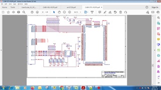

Hi sir,
we are using AM5728 reference design of custom board.
device are connected as below
MMC1 ----->SD Card
MMC2 ----->EMMC Device
MMC3 ----->WL1837 Wifi module.
I enable only two devices(mmc1,mmc2) in device tree using below method but it's now show any thing for emmc in beagle board x15 it's showing.

  • Hi Ramachandra
    Have you probed and checked whether the clock and supply is as per the expectation ?
    Diwakar
  • Hi sir,
    I checked the voltages 3.3v volts coming i will check the clock once and i will intimate you.(Rstout also coming)
    Thanking you,
    Ram.
  • Hi Ramachandra
    Also can you add #define CONFIG_MMC_TRACE in drivers/mmc/mmc_private.h in uboot repo
    build uboot and share the result.
    Diwakar
  • hi sir,
    I checked mmc3_clk but not generating the clock.

    Help share your schematic so that our HW engineers can review that.

  • To clarify,
    Are you receiving an MMC2_CLK signal at any point before/after U-boot?
    Are you receiving an MMC2_CMD signal at any point before/after U-boot? Note that CMD will not be constantly toggling, and will have short bursts when a command is issued.
    Both these signals are continuously low despite being pulled up to 3.3V?
    Marco
  • Hi Marco,
    we are getting MMC2_CLK continuously before/after U-boot.
    MMC2_CMD signal before U-Boot some pulse we are getting and after U-Boot prompt continuously low signal getting(when we will give commands also).
    Both Signals are not connected to 3.3v(DNI).
    Thanking you.
