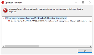

  • Hi Nick,
    i just tried to import the example into CCS from this site:
    https://git.ti.com/cgit/rpmsg/rpmsg_char_zerocopy/commit/?id=8957444374d790f0d9a6d026da9632793c9efb63
    I believe this is the part for the AM62xx M4F ?
     i got this error:
    can you please help?
    BR's
    Martin
  • Hello Martin,
    1) What version of CCS are you using, and what versions of Linux and MCU+ SDK are you using?
    2) In CCS, please check for updates and make sure the Sitara devices do not need an update.
    On my side, I will double-check on what versions were used to develop the example.
    Nick

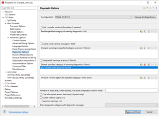

    Ok now i got it to work:
    had to add all linker libs:
    and also suppress that warning:
    With linker Runtime environment-> Initialization model changed to "Link using RAM autoinitialization model"
    i eliminated the warning:
    warning #10247-D: creating output section ".cinit" without a SECTIONS specification
    BR's
    Martin
