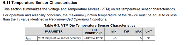

    We do not spec or guarantee any accuracy of our VTM module with regard to temperature measurements. We communicate +/-7degC for this part to give an idea to our customers of what level of accuracy they can expect for use in a system and we have performed internal characterization to confirm we are within these thresholds. If a more accurate measurement is needed, it is recommended for an alternative off chip measurement method to be used.
    Chris
  • Hello Dan,
    We are now including the VTM accuracy in the next revision of the processor-specific data sheet.
    Sreenivasa
