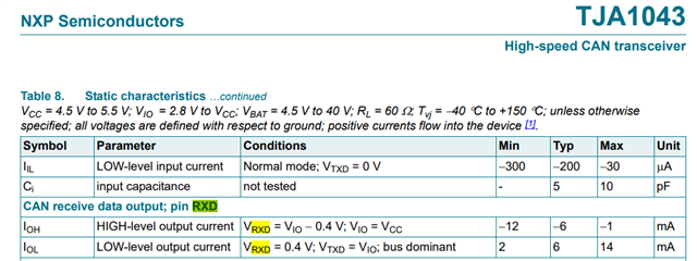

For AM6204 MCU_CAN port, there is no external pull up resistor added.
i want check the RX pin sink current capability , on the other hand please help check whether the external pull up resistor is need from TI view.
Belowe snapshot is for the CAN transceiver driver side capability 6~12mA.
