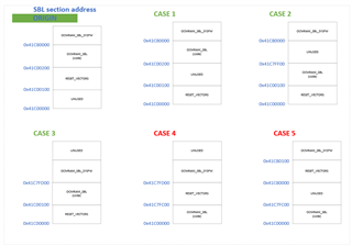

The boot mode is SBL, booting from the SD card. Sdk is 8.2.
1.We hope to optimize the address loaded by the sections of SBL in the linker.cmd file to reserve more OCMC (ie MCU_MSRAM0) memory space for mcu1_0.
The default section allocation address in the SDK is as follows:
The section allocation address we want is as follows:
As shown in the figure above, after SBL starts and loads DMSC successfully, we want to assign the memory address starting from 0x41C7FC00 to mcu1_0.

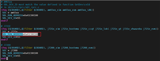

2.Currently we have tried modifying the section address schemes listed below:
According to the above schemes, modify the linker.cmd file and compile it into sbl boot firmware (tiboot3.bin). Make SD card boot firmware.
The case 1, case 2 and case 3 can boot successfully. But the case 4 and case 5 boot failed.
3.We found that ’RESET_VECTORS‘ must be placed before ‘OCMRAM_SBL’, so that the SBL firmware can start normally.
And the case 4 can't be achieved.
4.Is it possible to use case 4 to start sbl?
Or other solutions?
Please help us resolve this issue, thanks.
