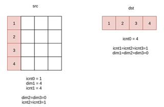

I'm trying to setup a Column2Row transformation using appUdma API, as depicted below:
As you can see, I'm using dicnt0 = 4, while icnt0 = 1. This does not work. However, if I use dicnt0=1, dicnt1=4, ddim1=1, then it works.
I haven't seen documented anywhere that dicnt0 should always be equal to icnt0. Is this UDMA API quirk?

  • That was probably initially a typo. I double-checked and it is what I'm using.
        prm.icnt0 = sizeof(float);
        prm.icnt1 = 4;
        prm.icnt2 = 1;
        prm.icnt3 = 1;
        prm.dim1 = sizeof(float) * 4;
        prm.dim2 = 0;
        prm.dim3 = 0;
        // set the dest parameters
        prm.dicnt0 = sizeof(float) * 4;
        prm.dicnt1 = 1;
        prm.dicnt2 = 1;
        prm.dicnt3 = 1;
        prm.ddim1 = 0;
        prm.ddim2 = 0;
        prm.ddim3 = 0;
    Output:
    src: {
      { 1, 2, 3, 4 },
      { 1, 2, 3, 4 },
      { 1, 2, 3, 4 },
      { 1, 2, 3, 4 },
    dst: {
      { 1, 0, 0, 0 },
      { 0, 0, 0, 0 },
      { 0, 0, 0, 0 },
      { 0, 0, 0, 0 },
    If I use this instead:
        prm.icnt1 = 4;
        prm.icnt2 = 1;
        prm.icnt3 = 1;
        prm.dim2 = 0;
        prm.dim3 = 0;
        prm.dicnt0 = sizeof(float);
        prm.dicnt1 = 4;
        prm.dicnt2 = 1;
        prm.dicnt3 = 1;
        prm.ddim1 = sizeof(float);
        prm.ddim2 = 0;
        prm.ddim3 = 0;
    Then it works:
    src: {
      { 1, 2, 3, 4 },
      { 1, 2, 3, 4 },
      { 1, 2, 3, 4 },
      { 1, 2, 3, 4 },
    dst: {
      { 1, 1, 1, 1 },
      { 0, 0, 0, 0 },
      { 0, 0, 0, 0 },
      { 0, 0, 0, 0 },

  • Hi Fred,
    Confirmed with the HW team, icnt0 and dicnt0 must be same in this case.
    Brijesh
