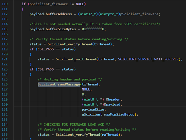

I'd like to know tifs.bin file.
Do I use different tifs.bin file in Custom HS-FS and Ti dummy key HS-FS?
I have two custom board keywrited by Custom key and Ti dummy key.

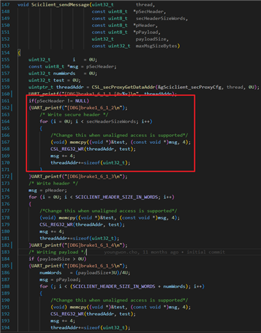

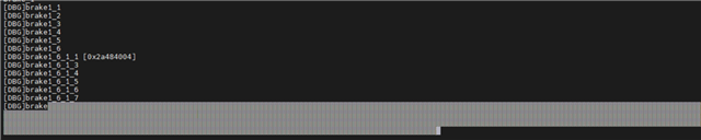

The Ti dummy key board works well but the Custom key board can't boot to the tifs.bin step.
I use the tifs.bin in SDK7_1 patched ES1_1 files. I signed the tifs.bin with each key.
In sciclient_rom.c stucked
In sciclient_secureproxy.c
Please guide.
Thank you.
  • Hi Youngwoo,
    tifs.bin that you copy or flash onto your boot media is the signed TIFS firmware with customer keys. The binary is concatenated together from the following 3 components: Cust.key signed outer certificate + TI Keys signed inner certificate + TIFS HS Encrypted Binary.
    The second and third binaries are provided in the TI RTOS SDK in the path <RTOS_SDK>/<PDK>/packages/ti/drv/sciclient/soc/sysfw/binaries. The binaries will be different between Silicon Revisions of the SoC, given that the TI Keys are different. These binaries are ti-fs-firmware-j721e-hs-cert.bin ti-fs-firmware-j721e-hs-enc.bin for SR1.0 and ti-fs-firmware-j721e_sr1_1-hs-cert.binti-fs-firmware-j721e_sr1_1-hs-enc.bin respectively for SR1.1.
    The combined image will be generated as tifs-hs-enc.bin for SR1.0 and tifs_sr1.1-hs-enc.bin for SR1.1. Please use the latter image for your device.
