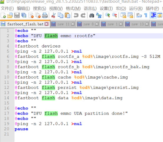

First, I written tiboot3.bin tispl.bin and u-boot.img into emmc with DFU. Upgrade succeeded.
Then, I boot device from eMMC and made it into fastboot mode to flash rootfs with fastboot_flash.bat
Fastboot flash failed

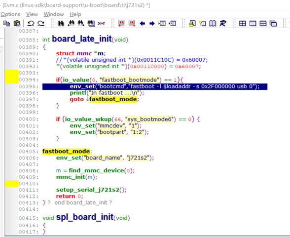

Failed to probe am65_cpsw_nuss driver
In fastboot ...
[ggf]board_late_init: bootcmd = fastboot -l $loadaddr -s 0x2F000000 usb 0

WARNING: unknown variable: is-logical
Starting download of 534864964 bytes
But with the same method, the j721e platform can successfully upgrade the emmc.
Please help to check why j721s2 failed to fastboot flash eMMC.
