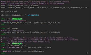

    It is suggested to build SDL on Linux as we do not build tests on Windows, but a quick fix to your issue might be to change the OS type from Windows to Windows_NT in the Rules.make file present in sdl/
    Josiitaa
  • Hello Josiitaa,
    I already try this by using "allclean" command as shown in attached screenshot.
    Also, Rule make file update for OS as Windows_NT , still facing issue.
