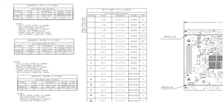

Hi Robert,
Thanks for your reply. Do we have FAB file for 10-layer design like below?

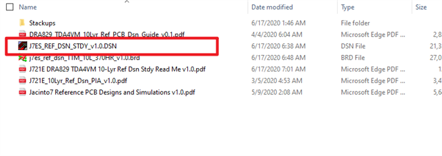

No - the reference design was a study, not a completed/built design. In the image you shared, there is a Stackups directory that should contain the PCB infomation.
