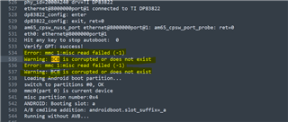

I met below error log with command "reboot recovery".
How can I solve this problem?

    if i'm not worng you flash on sdcard and not on emmc right ?
    you can try to stop uboot boot put in fastboot mode with this command in uboot : fastboot 0
    from  your pc launch :
    fastboot erase misc
    reboot and retry to see if you have same error.

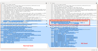

    Could you reproduce my problem?
    I compared the logs between a normal boot and an abnormal boot, and it seems that there is an issue when executing snapuserd.
    Does this relate to the issue?

  • Hi Ken,
    We have looked into the problem you have reported (cannot boot onto slot _b after upgrading due to snapuserd crash).
    This happens because we attempt to run snapuserd from the vendor_boot partition, which does not exist in ti-android-12.
    The following patch should resolve your issue. Can you please confirm this resolves it?
