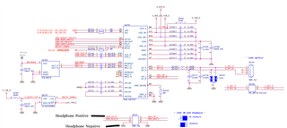

I am using DA7212 codec connected with AM6254 cpu over mcasp0. I have connected headphone negative terminal on GND and headphone positive terminal on I2S0_HP_R as shown in below figure. I am successfully detected codec as card1 and able to select it. I have played music through aplay -Dplughw:1,0 -t orgsong.wav and getting playback in slow motion than the original sound. I have also attached playback .wav file and original song file.
clock frequency of BCLK is at 1.4MHz and WCLK is at 21KHz.
Can you please suggest if any settings I have to do to get playback file same as original music file.

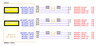

    Pin muxing
    main_mcasp0_pins_default: main-mcasp0-pins-default {
    	pinctrl-single,pins = <
    	//Connected with I2S0
    	AM62X_IOPAD(0x01a4, PIN_INPUT, 0) /* (B20) MCASP0_ACLKX.MCASP0_ACLKX */
    	AM62X_IOPAD(0x01a8, PIN_INPUT, 0) /* (D20) MCASP0_AFSX.MCASP0_AFSX */
    	AM62X_IOPAD(0x01a0, PIN_OUTPUT, 0) /* (E18) MCASP0_AXR0.MCASP0_AXR0 */
    	AM62X_IOPAD(0x019c, PIN_INPUT, 0) /* (B18) MCASP0_AXR1.MCASP0_AXR1 */
    	//Connected with I2S1
    	AM62X_IOPAD(0x01b0, PIN_INPUT, 0) /* (A20) MCASP0_ACLKR.MCASP0_ACLKR */
    	AM62X_IOPAD(0x01ac, PIN_INPUT, 0) /* (E19) MCASP0_AFSR.MCASP0_AFSR */
    	AM62X_IOPAD(0x0198, PIN_OUTPUT, 0) /* (A19) MCASP0_AXR2.MCASP0_AXR2 */
    	AM62X_IOPAD(0x0194, PIN_INPUT, 0) /* (B19) MCASP0_AXR3.MCASP0_AXR3 */
    I did codec connection with I2S port as per below image.
    Please suggest if I missed anything.
