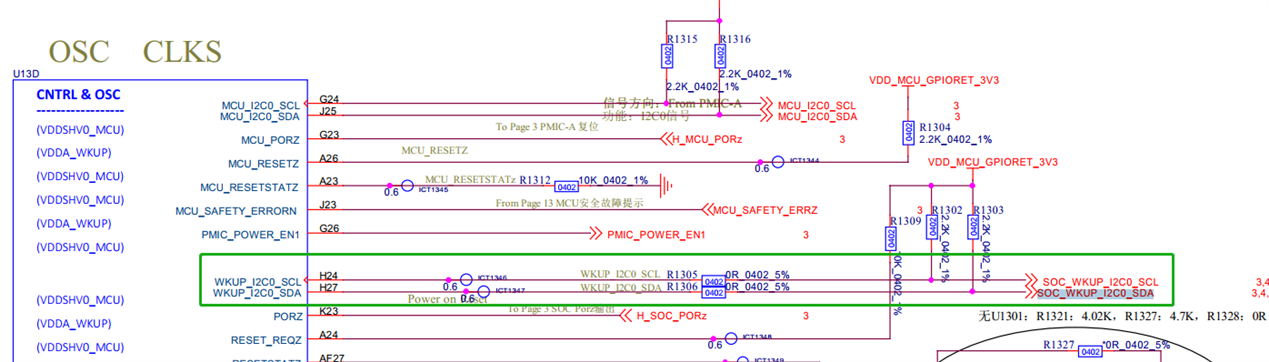

We use TDA4VL sdk J721-s2 8.04. We use pmic-b sw_b2a(VDD_FPD_1V1,as the figure) to power serial UB960, how to control the pmic output 1.1v in mcu2_0 side? Thanlks.
The PMIC-B SW_B2A/B is controlled via the I2C interface. The PMIC-B, TPS65941421, I2C address is 0x4C. The register to enable the regulator is 0x06, bit0 (BUCK2_EN) and bit4 (BUCK2_VMON_EN).
