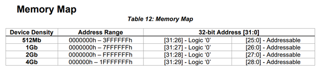

Here's a link to the datasheet
Want to boot from it, I assume this would need to be SPI0 (CS0) SPI EEPROM boot mode with single data line

On a quick look i am assuming that the device might not be supported by the Am335x SPI bpoot
AM335x
26.1.8.6 SPI
26.1.8.6.1 Features
• Supports 12-MHz clock (50% duty cycle).
• Supports only SPI Mode 3 (clock polarity = 1, clock phase = 1).
• Supports only 24-bit addressable EEPROMs.
• Supports only 4-pin SPI mode (CS, CLK, Serial Input, Serial Output).
• The boot devices must be connected to chip select 0 and must support the read command (03h).
• The boot image is copied into internal memory and then executed.

I think your right. I saw the MRAM device expects a 32-bit address field for the read commands. Our ROM code only sends a 24-bit address field. That right there makes it incompatible for boot.
For normal runtime accesses, I don't see any issues, 4-wire SPI mode 3. With proper driver software, they should be able to create read/write commands. They would only be able to access one chip select at a time even though the MRAM is a dual die device. They would also have to manage the block protection signals using GPIOs.
