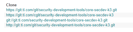

While following the directions (link to TI directions) for building the Processor SDK the following error was reported and the build failed:
Invoked by:
MACHINE=am62xx-evm bitbake tisdk-base-image
WARNING: ti-k3-secdev-native-git-r0 do_fetch: Failed to fetch URL git://git.ti.com/git/security-development-tools/core-secdev-k3.git;protocol=https;branch=master, attempting MIRRORS if available
ERROR: ti-k3-secdev-native-git-r0 do_fetch: Fetcher failure: Unable to find revision d14fbab5ccb21ffeb010ce57792c56a1308ed314 in branch master even from upstream
ERROR: ti-k3-secdev-native-git-r0 do_fetch: Bitbake Fetcher Error: FetchError('Unable to fetch URL from any source.', 'git://git.ti.com/git/security-development-tools/core-secdev-k3.git;protocol=https;branch=master')
ERROR: Logfile of failure stored in: /home/grahamreitz/tisdk/build/arago-tmp-external-arm-glibc/work/x86_64-linux/ti-k3-secdev-native/git-r0/temp/log.do_fetch.24041
ERROR: Task (virtual:native:/home/grahamreitz/tisdk/sources/meta-ti/recipes-ti/secdev/ti-k3-secdev_git.bb:do_fetch) failed with exit code '1'
NOTE: Tasks Summary: Attempted 1478 tasks of which 0 didn't need to be rerun and 1 failed.
NOTE: Writing buildhistory
NOTE: Writing buildhistory took: 13 seconds
NOTE: Writing buildhistory took: 6 seconds
Summary: 1 task failed:
Summary: There were 8 WARNING messages shown.
Summary: There were 2 ERROR messages shown, returning a non-zero exit code.
It appears that the link to the git repository is broken for the security development tools.
I tried to clone the repository from the command line and received the following error:
git clone git://git.ti.com/git/security-development-tools/core-secdev-k3.git;protocol=https;branch=master
Cloning into 'core-secdev-k3'...
fatal: remote error: access denied or repository not exported: /git/security-development-tools/core-secdev-k3.git
The host PC is Ubuntu Linux 18.04.
Did I miss something in the directions?
