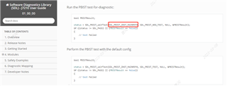

I find there are some PBIST instances in the SDL, but I can't match them with the safety mechanism.
For example, A safety mechanism called "ADC3 - PBIST check of memory",
will it be test if I perform PBIST with "SDL_PBIST_INST_MCUR5F0" instance like below example?
As lots of safety mechanisms like ADC3, so could you tell the relationship between PBST instance and safety mechanism?
This question is becasue we want to confirm the safety mechanism related PBIST are all implemented.
Thank you!

  • Hi Josiitaa,
    Thanks for your information, I have opened the 'SDL_J721E_diagnostic_mapping.xlsx' now.
    e.g.ADC3, it showed just need to use the API SDL_PBIST_getPOSTStatus to get result of PBIST check. But, which Pbist instance is the result for?
    Don't I firstly need to use the example API SDL_PBIST_selfTest to specify which PBIST instance intended to check? If needed, which instance should be take into below interface to relate to the ADC module?

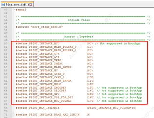

    Here is the instance enum list from SDL_RLS_01.00.00\sdl\src\sdl\pbist\soc\j721e\sdl_pbist.h:
    typedef enum {
    * MCU Instance
    SDL_PBIST_INST_MCUR5F0,
    * MCU Pulsar Instance
    SDL_PBIST_INST_MCUR5F1,
    * Main Pulsar Instance 0
    SDL_PBIST_INST_MAINR5F0,
    * Main Pulsar Instance 1
    SDL_PBIST_INST_MAINR5F1,
    * C7X Instance
    SDL_PBIST_INST_C7X,
    * A72 Instance
    SDL_PBIST_INST_A72,
    * VPAC Instance
    SDL_PBIST_INST_VPAC,
    * DMPAC Instance
    SDL_PBIST_INST_DMPAC,
    * NAVSS Instance
    SDL_PBIST_INST_NAVSS,
    * HC Instance
    SDL_PBIST_INST_HC,
    * C66X Instance 0
    SDL_PBIST_INST_C66X0,
    * C66X Instance 1
    SDL_PBIST_INST_C66X1,
    * Main Infrastructure Instance
    SDL_PBIST_INST_MAININFRA,
    * MSMC Instance
    SDL_PBIST_INST_MSMC,
    * Encoder Instance
    SDL_PBIST_INST_ENCODER,
    * Decoder Instance
    SDL_PBIST_INST_DECODER,
    * DSS/EDP/DSI Instance
    SDL_PBIST_INST_DSS,
    * GPU Instance
    SDL_PBIST_INST_GPU,
    } SDL_PBIST_inst;
    There are AUX_DEVICES defined for each core within sdl/examples/pbist/soc/j721e/pbist_defs.c for most of the Unique Identifiers with PBIST Diagnostic. I am checking with our experts and will get back to you regarding the instance to be called for the ADC module by the end of this week.

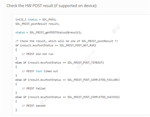

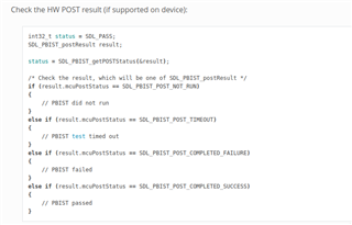

    The ADC3 module is covered as part of the MCU PBIST HW POST. So you do not have to run SDL_PBIST_selfTest. Just the SDL_PBIST_getPOSTStatus will work with instance PBIST_HWPOST_MCU_INDEX.

    Does PBIST HW POST take effect by setting below macro  BISTFUNC to enabled?
    HW POST can be tested by calling the SDL_PBIST_getPOSTStatus API as mentioned in the user guide.
    Josiitaa
  • Ok,Josiitaa. I know your mean. There is no need to enable the macro BISTFUNC. Just call the SDL_PBIST_getPOSTStatus API, this API can directly test HW POST and provide the test result. Thanks a lot.
