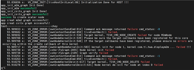

TDA4VM: TDA4AVM: M2M node verify failed
Part Number: TDA4VM

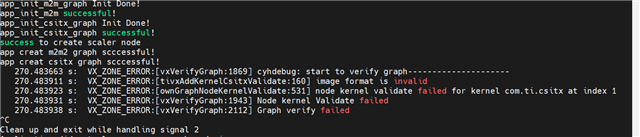

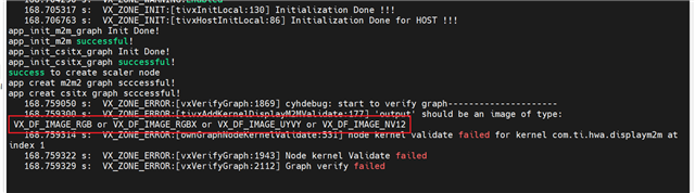

Hi, TI engineer,
After adding M2M node, I got below erorrs, how to solve this problem?
attach our board and sdk version information:
rtos: 08_04_00_06
linux: 08_04_00_11
boot mode: HLOS boot

  • Hi xie jc,
    But DSS M2M node is enabled in the vision apps, are there any crash on mcu2_0? Are you able to create any other node on mcu2_0?
    [MCU2_0]     15.048430 s: DSS: M2M Path is enabled !!!

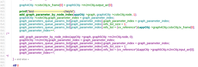

  • If you could also try removing DSS M2M input and/or output as graph parameter.
    Brijesh

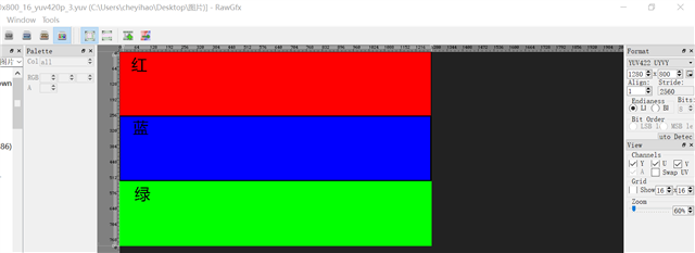

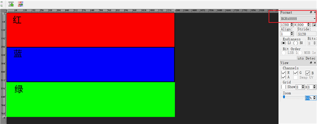

  • before adding m2m node,  using csitx node to display is ok, the flow is   "read uyvy picture -> csitx node"
  • Have you included Display in your makefile (BUILD_DISPLAY)? Because without display, DSS M2M cannot be used.
    Brijesh
  • I search "BUILD_DISPLAY" in vision_apps path,  but can not found desciption of this macro, where should i add this macro?

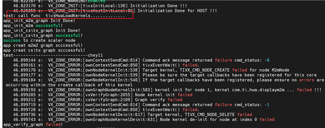

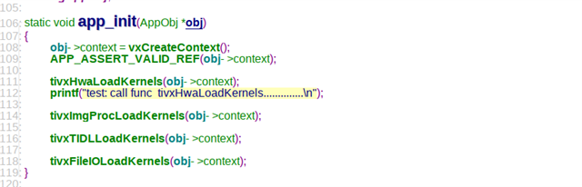

  • Which SDK are you using? SDK08.04?
    For this release, can you please check if you are calling tivxHwaLoadKernels API?  Because this API registers Display M2M kernel in OpenVX framework.
    Brijesh
    yes we call this function

  • Hi xie jc,
    I see it is returning error -8. As per fvid2 errors, it means EAGAIN error, which means it is already opened. Which input pipeline are you using for the DSS M2M path? or are you using DSS for the display path?
    Do you have CCS + JTAG available on this board? We can put breakpoint on create API of node and see where it is returning error.

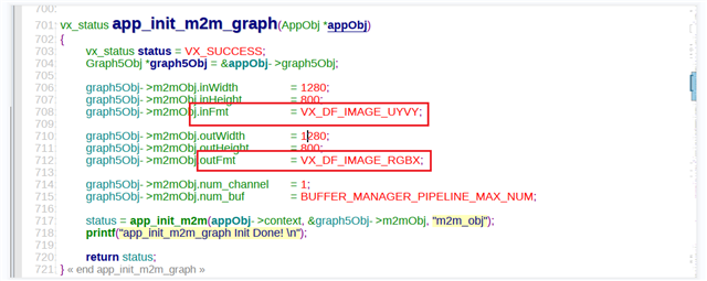

    I don't quite understand you.  the data flow is:    "uyvy picture ->(m2m input) -> m2m -> m2m output(rgbx) -> csitx"

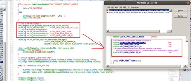

  • Hi xie jc,
    There are 4 video pipelines in the display, one of them is being used in the display m2m path as input path. Now which input pipeline are you using here in the m2m path? please check pipe id parameter in the display m2m parameters, this is used to tell the driver which input pipe to be used.
    Brijesh
  • Hi, Brijesh,
    I am using M2M1.
    Regards.
  • Hi xie jc,
    I means below highlighted parameters.

  • Hi, Brejesh,
    Regards.
    Can you please try below parameters? If this also does not work, we will have to connect CCS and check why DSS M2M is failing.
     tivx_display_m2m_params_init(&fmtObj->m2m_params);
     fmtObj->m2m_params.instId = 0u;
     /* Only one pipeline is supported */
     fmtObj->m2m_params.numPipe = 1u;
     fmtObj->m2m_params.pipeId[0U] = 3u;
     fmtObj->m2m_params.overlayId = 3u;
    Brijesh
  • Hi, Brejesh:
    This parameters is what i am using now..

  • Hi xie jc,

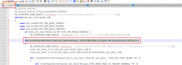

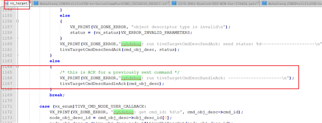

    ok, can you please put some print statements in the tivxDisplayM2MCreate API in the file tiovx\kernels_j7\hwa\display_m2m\vx_display_m2m_target.c to see if this API is getting called and if it is, then lets see where it is failing?
    Brijesh
  • Regards.
  • Yes, please do "make  sdk" and then "make linux_fs_install_sd".
  • Hi, Brijesh,
    I add some debug in csitx and m2m node target.c file
