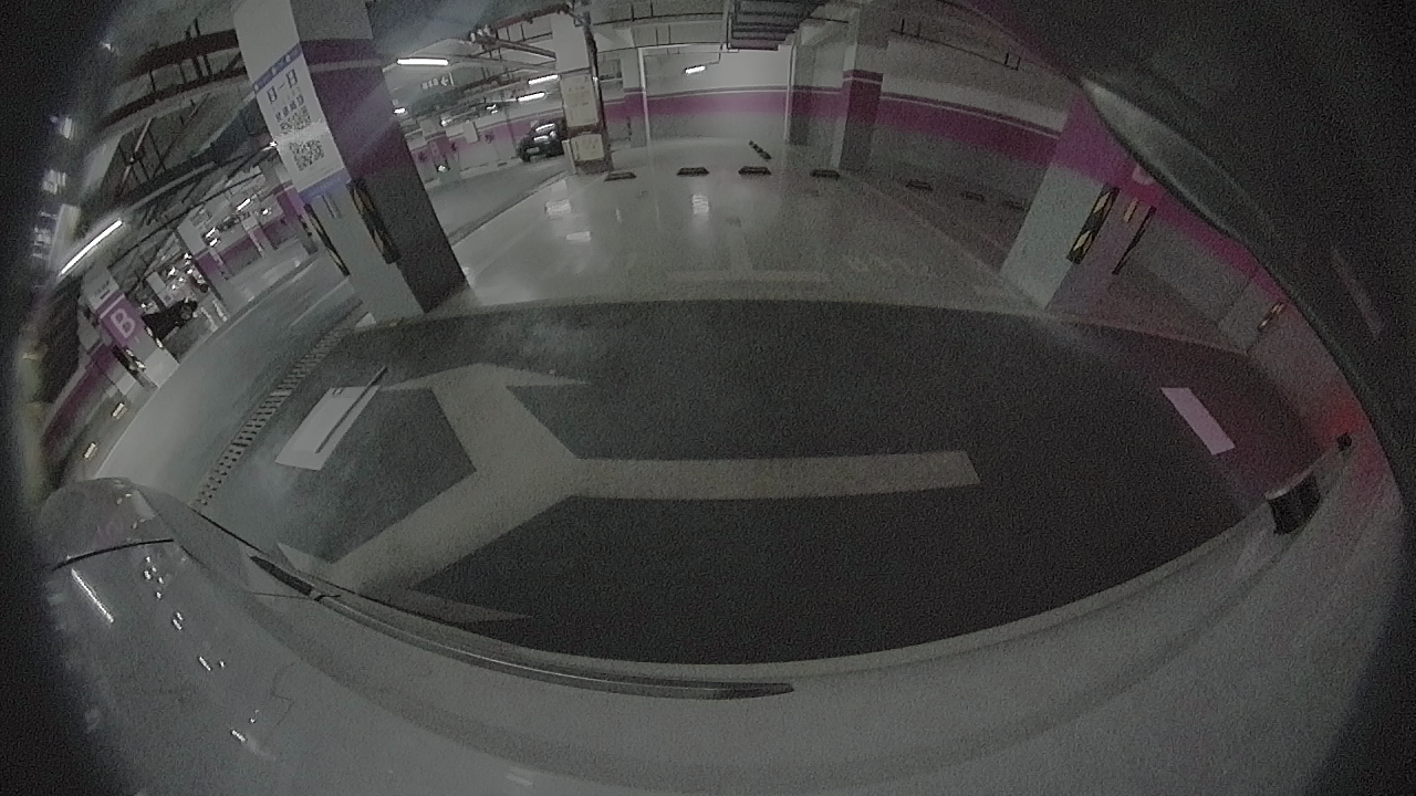

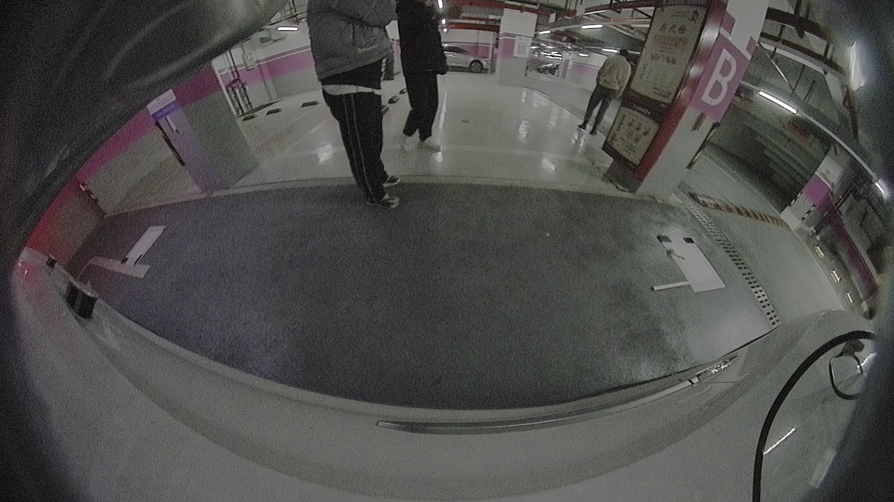

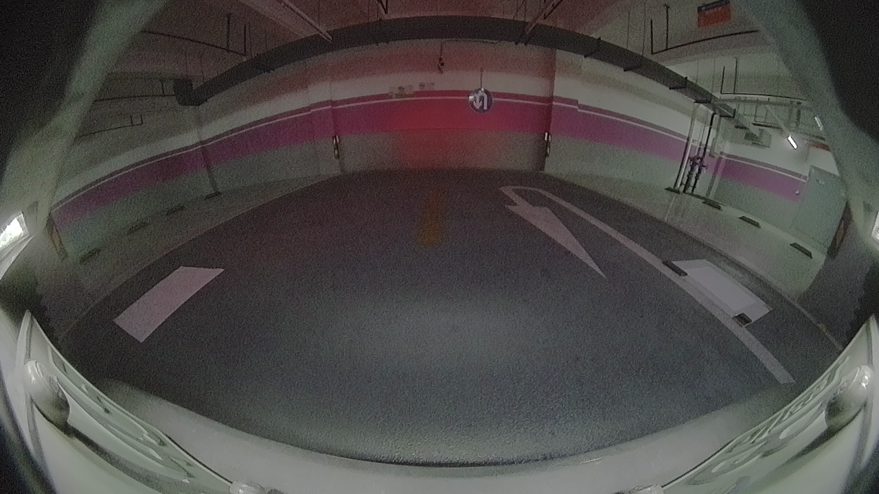

    3. Need to see captured images from front, left, rear and right cameras.
  • Hi Do-Kyoung,
    I posted this question for a customer, and he uploaded his front, right, back, and left four pictures just know. They are as follows.

  • 2. Where are your cameras installed?
    The cameras are installed under the front bumper, rear bumper and left and right rearview mirrors of the vehicle respectively.

  • Thanks for sharing images. I assume the customer is using white calibration charts.
    I do not see any reason that calibration fails. First of all, please just make sure that they put correct (acutal) chart sizes in Figure 11 (in your previous reply). Chart size shouldn't be scaled or magnified depending on car size.
  • No. The size we enlarged refers to the new size obtained by zooming in 7 times based on the size of the demo. Then, we used this new size to place the cameras in the corresponding positions around the car to collect surround-vision image data. Therefore, the surround-vision images we collected are strictly matched with our related parameters.
  • Okay. What you are saying is that the chart parameters match to your chart position. (Zooming 7 times made me confused. As long as chart parameters match to actual chart placement, calibration should work). I do not see any reason that calibration failed. One thing you need to check is the order of control points (4 control points from each chart) when you click them.
