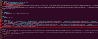

Build tiboot3.bin, tispl.bin, u-boot.img by Yocto,
Build MCU1_0 cddipc by RTOS SDK,
Boot the TDA4 failed with DFU mode, the following is the A72 console log output:
U-Boot SPL 2021.01-tda4jmcadcu (Mar 03 2023 - 06:29:00 +0000)
Model: Texas Instruments K3 J721E SoC
Board: Hirain-TDA4 rev V1.1
SYSFW ABI: 3.1 (firmware rev 0x0008 '8.4.1--v08.04.01 (Jolly Jellyfi')
Trying to boot from DFU
##################################################DOWNLOAD ... OK
Ctrl+C to exit ...
init_env from device 18 not supported!
Starting ATF on ARM64 core...
NOTICE:  BL31: v2.6(release):v2.7-rc0-dirty
NOTICE:  BL31: Built : 05:55:58, Nov  9 2022
I/TC:
I/TC: OP-TEE version: 3.17.0-125-g15a746d28 (gcc version 9.2.1 20191025 (GNU Toolchain for the A-profile Architecture 9.2-2019.12 (arm-9.10))) #1 Wed Nov  9 05:19:03 UTC 2022 aarch64
I/TC: WARNING: This OP-TEE configuration might be insecure!
I/TC: WARNING: Please check https://optee.readthedocs.io/en/latest/architecture/porting_guidelines.html
I/TC: Primary CPU initializing
I/TC: SYSFW ABI: 3.1 (firmware rev 0x0008 '8.4.1--v08.04.01 (Jolly Jellyfi')
I/TC: HUK Initialized
E/TC:0 0 k3_sec_proxy_verify_thread:108 Queue is busy
E/TC:0 0 k3_sec_proxy_recv:196 Thread SEC_PROXY_RESPONSE_THREAD verification failed. ret = -65523
E/TC:0 0 ti_sci_get_response:101 Message receive failed (-65523)
E/TC:0 0 ti_sci_do_xfer:149 Failed to get response (-65523)
E/TC:0 0 sa2ul_init:58 Failed to get SA2UL device
E/TC:0 0 call_initcalls:43 Initcall __text_start + 0x0005b4a0 failed
I/TC: Primary CPU switching to normal world boot

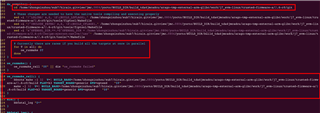

We use the following command to build MCU1_0 cddipc module:
mcusw/build$
mcusw/build$ make cdd_ipc_profile_app BOARD=j721e_evm SOC=j721e BUILD_PROFILE=release CORE=mcu1_0 BUILD_OS_TYPE=freertos
We add lds script file to build cddipc image:

  • Hi Sikai,
    We use bl31.bin and bl32.bin compiled by Yocoto, but still boot failed with the same fail log.
    1. BL31.bin compile script:
    2. BL32.bin compile script:
    3. BL31.bin and BL32.bin files dir:
    4. boot fail log:
    Any other suggestions?
