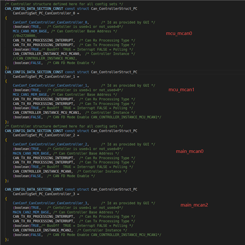

Debug CAN driver in mcu3_0 where both the MCU domain CAN and the main domain CAN are used:
In the initialization list:
When debugging with canoe, only the two can in front of the initialization list can be sent. Only the first two can can be used, regardless of the initialization sequence, whether MCU_can or main_can. It also indicates that there is no problem with the hardware configuration of CAN. But this error will still occur. (On mcu3_0, the MCU_can interrupt is already mapped)
The customer would like to know the possible cause of this issue. Thanks.

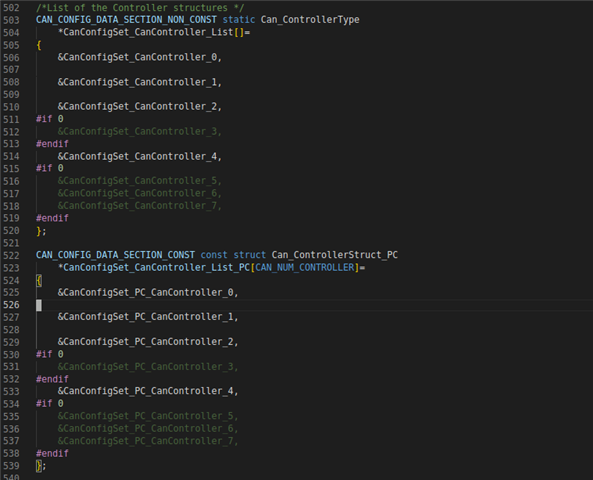

  • In the first screen shot
    CanConfigSet_CanController_3 is used,
    and
    In the second screen shot
    CanConfigSet_CanController_3 is in undefined region.
    Could you explain this change ?
    Tarun Mukesh
  • ti-processor-sdk-rtos-j721e-evm-08_01_00_13
  • sorry, CanConfigSet_CanController_3 is defined.
    And ,i don't understand, why "CanConfigSet_CanController_3 is used" ?

  • CanConfigSet_CanController_3 is defined , 【Replace CanConfigSet_CanController_4 with CanConfigSet_CanController_3】
  • I had read " mcal_drv/mcal/examples/Can/soc/j721e/mcu2_1/CanApp_Startup.c",but it does'not work.

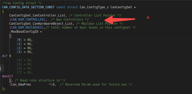

    I want to say:
    I had define four controller (mcu_can0, mcu_can1, main_can0, main_can2), but only the first two controller of the initialization list are available.
  • If the initialization order is: (mcu_can0, mcu_can1, main_can0, main_can2), Only 【mcu_can0, mcu_can1】is available。
    If the initialization order is: (mcu_can0, main_can2, main_can0, mcu_can1), Only 【mcu_can0, main_can2】is available。
    Only the first two controller of the initialization list are available

  • I had read " mcal_drv/mcal/examples/Can/soc/j721e/mcu2_1/CanApp_Startup.c", but when I dapted to MCU3_0 and didn't work.
    I use custom board. I do internal receive.

    CAN_CONFIG_DATA_SECTION_NON_CONST static Can_ControllerType
        CanConfigSet_CanController_0 =
        &CanConfigSet_CanController_0_CanControllerBaudrateConfig_0,  /* pointer to default Baud structure */
        CanConfigSet_CanController_0_BaudRateConfigList,  /* List of available Baudrate structs */
        CanConfigSet_CanController_1 =
        &CanConfigSet_CanController_1_CanControllerBaudrateConfig_0,  /* pointer to default Baud structure */
        CanConfigSet_CanController_1_BaudRateConfigList,  /* List of available Baudrate structs */
    /* Controller structure defined here for all config sets */
        CanConfigSet_CanController_2 =
        &CanConfigSet_CanController_2_CanControllerBaudrateConfig_0,  /* pointer to default Baud structure */
        CanConfigSet_CanController_2_BaudRateConfigList,  /* List of available Baudrate structs */
        CanConfigSet_CanController_3 =
        &CanConfigSet_CanController_3_CanControllerBaudrateConfig_0,  /* pointer to default Baud structure */
        CanConfigSet_CanController_3_BaudRateConfigList,  /* List of available Baudrate structs */
        CanConfigSet_CanController_4 =
        &CanConfigSet_CanController_4_CanControllerBaudrateConfig_0,  /* pointer to default Baud structure */
        CanConfigSet_CanController_4_BaudRateConfigList,  /* List of available Baudrate structs */
    #if 0
        CanConfigSet_CanController_5 =
        &CanConfigSet_CanController_5_CanControllerBaudrateConfig_0,  /* pointer to default Baud structure */
        CanConfigSet_CanController_5_BaudRateConfigList,  /* List of available Baudrate structs */
        CanConfigSet_CanController_6 =
        &CanConfigSet_CanController_6_CanControllerBaudrateConfig_0,  /* pointer to default Baud structure */
        CanConfigSet_CanController_6_BaudRateConfigList,  /* List of available Baudrate structs */
        CanConfigSet_CanController_7 =
        &CanConfigSet_CanController_7_CanControllerBaudrateConfig_0,  /* pointer to default Baud structure */
        CanConfigSet_CanController_7_BaudRateConfigList,  /* List of available Baudrate structs */
    #endif
    CAN_CONFIG_DATA_SECTION_CONST const struct Can_ControllerStruct_PC
        CanConfigSet_PC_CanController_0 =
        CanConf_CanController_CanController_0,      /* Id as provided by GUI */
        (boolean)TRUE,   /* Contoller is used=1 or not_used=0*/
    	MCU_CAN0_MEM_BASE, /* Can Controller Base Address */
        //0x2728000,
        CAN_TX_RX_PROCESSING_INTERRUPT,  /* Can Rx Processing Type */
        CAN_TX_RX_PROCESSING_INTERRUPT,  /* Can Tx Processing Type */
        (boolean)TRUE,/* BusOff  TRUE = Interrupt FALSE = Polling */
    	CAN_CONTROLLER_INSTANCE_MCU_MCAN0,  /* Controller Instance */
        //CAN_CONTROLLER_INSTANCE_MCAN2,
    	(boolean)FALSE,  /* CAN FD Mode Enable */
        CanConfigSet_PC_CanController_1 =
        CanConf_CanController_CanController_1,      /* Id as provided by GUI */
        MCU_CAN1_MEM_BASE, /* Can Controller Base Address */
    	CAN_CONTROLLER_INSTANCE_MCU_MCAN1,  /* Controller Instance */
    	(boolean)FALSE,  /* CAN FD Mode Enable CAN_CONTROLLER_INSTANCE_MCU_MCAN1*/
        CanConfigSet_PC_CanController_2 =
        CanConf_CanController_CanController_2,      /* Id as provided by GUI */
        MAIN_CAN0_MEM_BASE, /* Can Controller Base Address */
    	CAN_CONTROLLER_INSTANCE_MCAN0,  /* Controller Instance */
        CanConfigSet_PC_CanController_3 =
        CanConf_CanController_CanController_3,      /* Id as provided by GUI */
    	MAIN_CAN2_MEM_BASE, /* Can Controller Base Address */
    	CAN_CONTROLLER_INSTANCE_MCAN2,  /* Controller Instance */

    	CAN_CONTROLLER_INSTANCE_MCAN7,  /* Controller Instance */
    #endif
    /*List of the Controller structures */
        *CanConfigSet_CanController_List[]=
        &CanConfigSet_CanController_0,
        &CanConfigSet_CanController_1,
        &CanConfigSet_CanController_2,
        &CanConfigSet_CanController_3,
    #if 0
        &CanConfigSet_CanController_4,
        &CanConfigSet_CanController_5,
        &CanConfigSet_CanController_6,
        &CanConfigSet_CanController_7,
    #endif
        *CanConfigSet_CanController_List_PC[CAN_NUM_CONTROLLER]=
        &CanConfigSet_PC_CanController_0,
        &CanConfigSet_PC_CanController_1,
        &CanConfigSet_PC_CanController_2,
        &CanConfigSet_PC_CanController_3,
    #if 0
        &CanConfigSet_PC_CanController_4,
        &CanConfigSet_PC_CanController_5,
        &CanConfigSet_PC_CanController_6,
        &CanConfigSet_PC_CanController_7,
    #endif

    Thanks for sharing.
    the error log when customer using the latter 2 controllers.
    Can you share this as well ?
    Tarun Mukesh
  • I use CANOE to send packets to the next two controllers, but CANOE directly reports an error. Other than that, there is no error log.
    Follow is CANOE error:
    This error only occurs when the last two CAN controllers are tested with CANOE.
  • ISR is defined in Can_Irq.c
    All ISRs for can are defined in can_irq.c (these ISRs come with the SDK), and what I can be sure of is that ISRs for all controllers in can_cfg.c are defined and used (I printed them out in CCS)
    If CAN node fails to acknowledge the message received we can get the error , it can happen if the message fails at filtering as well.Can you check that ?
    My suggestion would be can you use configuration tool to generate these files ? instead manually writing out these .
    Tarun Mukesh
  • 1,I have a question that what is "the message fails at filtering". Do you mean that if the sent packet does not belong to this can node, CANOE will also report an error? I have tested that if the sent message does not belong to this can node, this error will not appear on CANOE.
    2,I don' t have EB tresos. I have emailed TI hoping to get a TI license for EB tresos, but it has not been approved. So I had to change it by manual.
  • I have a question that what is "the message fails at filtering". Do you mean that if the sent packet does not belong to this can node, CANOE will also report an error? I have tested that if the sent message does not belong to this can node, this error will not appear on CANOE.
    No. I meant to say if the intended recipient of the CAN message don't acknowledge ,then this error can come.
    I need to verify the changes , as these are done manually. I will get back to you with updates.
    In the meanwhile, Can you please check with default config files of MCU1_0 which has 2 MCU CAN and 1 MAIN CAN whether that is working for you ?
    Tarun Mukesh
  • 1,Thank you for helping verify。
    2,In the SDK, MCU2_1 demo uses mcu_can0/1, main_can, which I mcu3_0 application is a reference mcu2_1, but it does not work. At the same time I would like to ask, about all the configurations of the main_can. (Including the supported baud rate and so on, I use 500kbps)
  • My understanding is that mcu1_0 is of the MCU domain, mcu3_0 of the main domain, and the configuration of the MCU domain does not fully apply to the main domain, and interrupt mapping is required in the main domain, but I have done these interrupt mappings.
  • Hello
    Can you please look into this?
    eason zhou,
    It is not recommended to change it manually some or the other might trigger the problem.
    MCU2_1 demo uses all main domain CAN and MCU1_0 demo uses 2 MCU_CAN and 1 Main CAN.
    By default we use standard CAN 1Mbps and CANFD 5Mbps.
    Can you please verify whether on your application side  , no hard coding on number of controller is present ?
    Tarun Mukesh
  • On my application side, there is no limit to the number of controllers, because the maximum supported can controller is 16, which we have not changed.
    Can you help verify the configuration I modified manually above? Thank you~
  • Can you help verify the configuration I modified manually above?
    It is becoming really difficult to identify root cause of issue from these files and generalised log error, as there are lot of changes from the expected.
    I have requested to provide necessary support in getting you the licence , then you can generate the files and validate .
    If the problem persists i can support you.
    I hope you understand
    Tarun Mukesh
  • Thanks for your support, I've sorted it all out.
  • Thanks eason zhou
