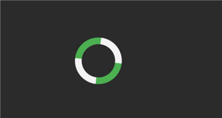

The performances a really bad, the HTML app is not usable CSS animation are blinking.
So I stop all application and nginx server and add a simple html file with a simple CSS animation on the file system.
1/ I launch manually weston
2/ I launch chromium pointing on the local file
3/ CSS animation is blinking, the image is not fully refreshed, some white line appear.
