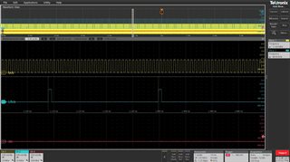

as below part of log (Error playing sample), we modified davinci-mcasp.c or machine driver clock, but it no work. (no sound)
is it possible modify BIT clock from SOC side to 2.822 Mhz (I want to try it matches codec or not)
because, from the attachment file waveform (blue wave), soc BIT clock about 1.4Mhz
or what else cay try

  • Hi TI
    update my trace code, in order to match rt5640 clock requirement, then I compare EVM log
    I modified the machine driver let davinci-mcasp.c line 1243,  mcasp->sysclk_freq is 96000000
    It already produces MCLK is 24.576Mhz, BCLK is 3.072Mhz, lrclk is 48Khz
    but tinyplay still get Error playing sample, did any advice
    thx

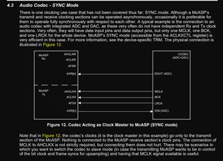

  • Hi Victor,
    From the logs that you have shared, I understand McASP is slave and RT5640 is codec master, correct?
    On AM62x McASP is slave and tlv320aic3106 is the master.
    DTS file with this configuration as a reference can be found in the below link:
    https://git.ti.com/cgit/ti-linux-kernel/ti-linux-kernel/tree/arch/arm64/boot/dts/ti/k3-am62x-sk-common.dtsi?h=ti-rt-linux-5.10.y
    As you would see in this file,
    clock-frequency = <12288000> which is the MCLK from codec
    Hope this helps. Please don't hesitate to contact for further assistance.
    Best Regards
    Suren
  • Hi Suren Porwar
    thx your information, yes, in my case, RT5640 is codec master, and we check TI AM625 tlv320aic3106 is master too
    do you know , if our rt5640 use 24.576Mhz MCLK as photo, mcasp side is supported or not (mcasp is slave) ? or need to modify some code
    this is part of the schematics of our codec
    because tinyplay still have problem

  • Hi Victor,
    Can you share the changes you have made and DTS file with your changes to understand the issue?
    Best Regards
    Suren
  • Hi Suren Porwar
    OK, As an attachment file (I am not sure file is upload or not, file name -> k3-am62x-sk-common-ms5t04)
    I also put part of dts code in below, and machine driver I changed, because previous project used, if any information, reply me
    thx
    #if 1 //====>audio test rt5640
    	codec_audio: sound {
    		compatible = "fsl,imx-audio-rt5640";
    		model = "rt5640-audio";
    		audio-routing =
    			"Headphone Jack", "HPOL",
    			"Headphone Jack", "HPOR",
    			"Ext Spk", "SPOLP",
    			"Ext Spk", "SPOLN",
    			"Ext Spk", "SPORP",
    			"Ext Spk", "SPORN",
    			"DMIC","IN1P";
    		cpu-dai = <&mcasp0>;
    		audio-codec = <&rt5640>;
    		clocks = <&ext_rt5640_mclk>;
    #endif //====>audio test rt5640
    &mcasp0 {
    	status = "okay";
    	#sound-dai-cells = <0>;
    	pinctrl-names = "default";
    	pinctrl-0 = <&main_mcasp0_pins_default>;
    	op-mode = <0>;          /* MCASP_IIS_MODE */
    	tdm-slots = <4>;
    	auxclk-fs-ratio = <0>;
    	serial-dir = <  /* 0: INACTIVE, 1: TX, 2: RX */
    	       1 0 2 0
    	       0 0 0 0
    	       0 0 0 0
    	       0 0 0 0
    	tx-num-evt = <32>;
    	rx-num-evt = <32>;
    #endif //<====audio test
    	main_mcasp0_pins_default: main-mcasp0-pins-default {
    		pinctrl-single,pins = <
    			AM62X_IOPAD(0x00a4, PIN_INPUT, 0) /* (B20) MCASP0_ACLKX bitclk*/
    			AM62X_IOPAD(0x00a8, PIN_INPUT, 0) /* (D20) MCASP0_AFSX lrclk*/
    			AM62X_IOPAD(0x00a0, PIN_OUTPUT, 2) /* (L25) MCASP0_AXR0  serial data in/out*/
    			AM62X_IOPAD(0x0098, PIN_INPUT, 0) /* (A19) MCASP0_AXR2  serial data in/out*/
    #endif //<===audio test
    #if 1 //audio test rt5640
    	rt5640: audio-codec@1c {
    		compatible = "realtek,rt5640";
    		reg = <0x1c>;
    		status = "okay";
    		/* Regulators //may be not used in rt5640
    		AVDD-supply = <&vcc_3v3_sys>;
    		IOVDD-supply = <&vcc_3v3_sys>;
    		DRVDD-supply = <&vcc_3v3_sys>;
    		DVDD-supply = <&vcc_1v8>;
    #endif
    	ext_rt5640_mclk: clk-0 {
    		#clock-cells = <0>;
    		compatible = "fixed-clock";
    		clock-frequency = <24576000>;
  • Hi Victor,
    I see you are using tdm_slots =<4>
    In the case of I2S, there are two slots per frame. Each slot consists of 32 bits. Even if the data payload is only 16 bits or 24 bits, it is encapsulated within a 32-bit word. Based on this logic: 2 slots * 32 bits per slot * 48 kHz = 3.072 MHz bit clock should be BCLK.
    Your log shows 1536000 as BCLK.
    Please refer this below document on designing a system with McASP.
    https://www.ti.com/lit/an/sprack0/sprack0.pdf
    Hope this helps in your debugging.
    Best Regards
    Suren
  • Hi Suren Porwar
    thx, actually I try 2 and 4 before, now I modified tdm_slots =<2>
    and thx for the pdf, I read page 12 like our schematics, look like below soc & codec side
    one of strange is when I tinyplay command, no data output from soc (red waveform)
    and this is my mcasp0 interface
    			AM62X_IOPAD(0x00a0, PIN_OUTPUT, 0) /* (E18) MCASP0_AXR0 serial data out*/
    			AM62X_IOPAD(0x0098, PIN_INPUT, 0) /* (A19) MCASP0_AXR2 serial data in*/
    is there any need to be modifed or I missed
    //soc side
    //codec side

    //part of pcm_lib.c
    if (!tout) {
    pcm_dbg(substream->pcm,
    "%s write error (DMA or IRQ trouble?)\n",
    is_playback ? "playback" : "capture");
    printk("pcm_lib.c write error (DMA or IRQ trouble?)...\n");  ===> error in here
    err = -EIO;
    break;
    //part of log

    aaaaaa........
    [ 79.829392] pcm.h snd_pcm_playback_avail avail is 4096
    [ 79.836304] pcm.h snd_pcm_playback_avail avail is 0
    [ 79.841207] pcm.h snd_pcm_playback_avail avail is 0
    [ 79.846142] soc-dai.c snd_soc_pcm_dai_trigger...
    [ 79.850785] pcm.h snd_pcm_playback_avail avail is 0
    cccccc........
    [ 79.856337] pcm.h snd_pcm_playback_avail avail is 96
    [ 79.862553] pcm.h snd_pcm_playback_avail avail is 96
    [ 79.867992] pcm_lib.c in the wait_for_avail...
    [ 79.872464] pcm_lib.c wait_for_avail snd_pcm_avail...
    [ 79.877521] pcm.h snd_pcm_playback_avail avail is 0
    [ 90.083577] pcm_lib.c wait_for_avail tout is 0...
    [ 90.088309] pcm_lib.c write error (DMA or IRQ trouble?)...
    [ 90.093780] pcm_lib.c err = wait_for_avail(substream, &avail) , err is -5
    [ 90.101120] pcm.h snd_pcm_playback_avail avail is 0
    [ 90.105992] pcm_lib.c in the wait_for_avail...
    [ 90.110424] pcm_lib.c wait_for_avail snd_pcm_avail...
    [ 90.115460] pcm.h snd_pcm_playback_avail avail is 0
    [ 100.323572] pcm_lib.c wait_for_avail tout is 0...
    [ 100.328308] pcm_lib.c write error (DMA or IRQ trouble?)...
    [ 100.333779] pcm_lib.c err = wait_for_avail(substream, &avail) , err is -5
    dddddd........
    [ 100.340756] soc-dai.c snd_soc_pcm_dai_trigger...
    [ 100.346707] soc-dai.c snd_soc_dai_digital_mute...
    [ 100.353272] soc-dai.c soc_dai_ret...ret is -524
    [ 100.357795] soc-dai.c snd_soc_dai_digital_mute...
    [ 100.362490] soc-dai.c soc_dai_ret...ret is -524
    [ 101.379575] ti-udma 485c0100.dma-controller: chan1 teardown timeout!
  • Hi Suren Porwar
    Finally, I check soc no data output when play music, the reason is mcasp0 setting got wrong, fix it.
    really thx help
