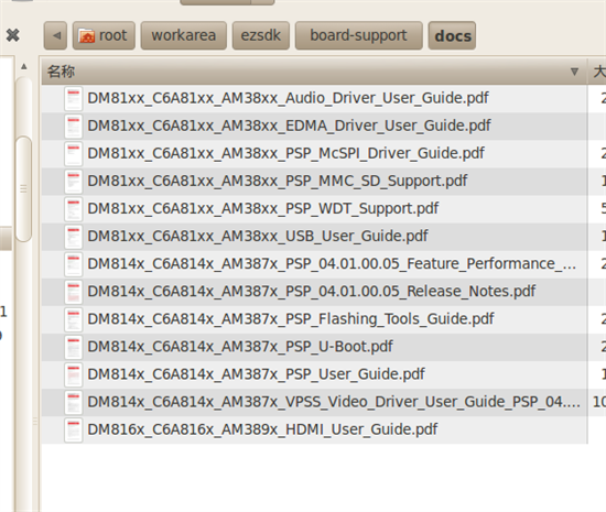

  • Hi Viet,
    Where can I find the user guide? What is the TRM means?
    I could find all the docs about 8148 as following image :
    Yanbin Yue
  • TRM means "TMS320DM814x DaVinci Digital Media Processors Technical Reference Manual"
    http://www.ti.com/lit/ug/sprugz8/sprugz8.pdf
