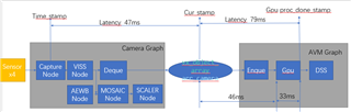

    Take GRAPH1 as an example,we got the GTC timestamp added to the captured frame,and got the GTC timestamp of WISS, delay is the time difference between the two.
    For the GRAPH2, we got the GTC timestamp of WISS from GRAPH1 and passed it to the Gpu (
    img_input_desc[0]->base.timestamp), then  got the GTC timestamp When run the Process Funtion of Gpu Node. finally,
    Calculated the time difference between the two.

    As discussed in the call, could you please provide a brief about your usecase?
    It would also be great if you could provide a diagram ( or something similar ) showing the points where you are trying to profile in your graph.
    Nikhil

  • Hi, Nikhil
    1. Please find attchment of e2e.pptE2E.pptx
    2. I'm sorry that our source code cannot be open source.  but I will provide you with a reproducible DEMO for testing. It is currently under development and will be uploaded later.
    3. The two Graphs are in VX_GRAPH_SCHEDULE_MODE_QUEUE_AUTO mode and only scheduled within the main process for enqueue and dequeue.
    Best wishes!

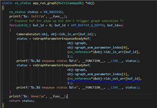

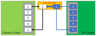

    1. Regarding the first issue, where you see around 85-90 msec from Enqueue of LDC input to Enqueue of SRV input:
    The time difference is observed here as the timestamp in src_frame in SrvPutBuf() would be of the first buffer enqueued (i.e., during app_run_graph in camera_init), whereas the cur_stamp in SrvPutBuf() would be after 3 (initial buffers) + 1 (enqueue buffer in CameraGetBuf).
    Hence this initial delay of 4 frames is always propogated through out the run showing 85-90 msec.
    I have modified the code a bit in fw_camera.c and fw_srv.c as attached below.
    /cfs-file/__key/communityserver-discussions-components-files/791/cc_5F00_avm.zip
    With the above, I'm able to get around 34msec as shown below
    I think this way of implementation, or something similar on your application code should resolve the first part of the issue
    There are some strange points about the modified the code , please help to Further analysis,
    if (first == 0)
            CameraDataSet(obj->ldc_in_arr[0]);
            vxGraphParameterEnqueueReadyRef(
                    obj->graph,
                    obj->graph_avm_parameter_index[0],
                    (vx_reference*)&obj->ldc_in_arr[0],
                    1);
            first = 1;
        else
            status = vxGraphParameterDequeueDoneRef(
                    obj->graph,
                    (vx_reference*)&tmp_frames,
                    1,
                    &num_refs);
            if ((status == VX_SUCCESS))
                CameraDataSet(tmp_frames);
                        obj->graph,
                        1);
                obj->graph,
                obj->graph_avm_parameter_index[1],
                (vx_reference*)_frames,
                1,
                &num_refs);
            return 1;

    The root cause for the first part of latency as based on the app you had provided, is because
    1. You are doing a 3 buffer pipe-up initially for the cam graph.
    2. The 4 buffer gets enqueued first with filled values, and then you are dequeueing the cam graph ldc output.
    3. This ldc output would consists of the timestamp (if provided) during the pipeup. Else the timestamp value is zero.
    4. Once this buffer is dequeued (already with a 3 buffer latency with the current timestamp because it is a pipeup buffer), you would be checking to dequeue the srv graph input buffer. (This would be available at first but if not available at that moment, you are skipping it by vxGraphParameterCheckDoneRef() leading to additional 1 frame latency)
    5. Now, this 4 frames latency would be propagated all alone the runs because you are doing both graphs enqueue and dequeue in a single task.
    Hence, you are seeing this latency for the first part of the graph.
    Now, regarding the second part, I have checked internally with GPU expert regarding the performance of GPU (QNX vs Linux).
    We are checking internally if there is a difference in the performance. But here we could only confirm the same. The improvement in the performance should come from QNX as the driver implementation is from QNX.
    Is there a good way to keep the frame rate and reduce the latency?
    The only way currently I see is to keep the srv graph (enq and deq) and cam graph (enq and deq) in separate tasks, and point the output buffer of ldc as input of srv in graph parameter.
    The above method would not only avoid the latency (by unblocking deq of srv graph whenever it is ready), but also avoids memcpy as the same buffer is being pointed to both graphs (ldc o/p and srv i/p)
    Please refer this implementation below
    /cfs-file/__key/communityserver-discussions-components-files/791/cc_5F00_avm_5F00_dual_5F00_task.zip
    Please check the changes made in main.c and SrvInit()
    Note: The timing calculation would be a bit off as the same buffer is being used here currently. Could you please update this implementation and let me know if there is improvement in latency and fps?
    Nikhil

    b) SRV Graph Input  will CAM Graph Output tmp_frames[0], which has not been completely written. This kind of scene is likely to lead to screen tearing
    Sorry. In the implementation, it is currently,
    TASK 1: DQ LDC o/p -> EnQ LDC o/p
    TASK 2: DQ SRC i/p -> EnQ SRV i/p
    In the above case, you are correct, there are chances that LDC is writing the o/p and SRV reading it would happen same time and half written image.
    Could you make a small correction as shown below
    TASK 1: DQ LDC o/p -> EnQ SRV i/p
    TASK 2: DQ SRC i/p -> EnQ LDC o/p
    In this case, there shouldn't be simultaneous access to buffer as the Dq function is a blocker function that would provide the buffer only when the buffer is filled.
    Could you please try this change at your end? This should give better FPS and less latency.
    Is this allowed by the OPENVX architecture?
    Yes, this is allowed. I do not an issue with this approach from the architecture point of view.
    I agree, this should be solved by the method suggested above.
    If the actual scheduling cycles of two GRAPHs are different, i s there a phenomenon of video frame disorder?
    The frames should be in order with the method suggested above.

    How should the actual latency of GRAPH be calculated? Is it an accumulation of time spent by all nodes?
    The Latency is usually the time spent by nodes + graph latency (i.e., ipc latency, buffer transfer etc.). But usually, the graph latency is very less compared to the node performance time.
    Usually, we calculate the latency by using the timestamp provided in the capture node and read this back in the display node (process function) and get the timestamp locally at that moment in the display node. The difference should give you the latency for the flow.
    Nikhil

    LATENCY:         Camera -->   GPU Input que: avg =     92420 usecs, min/max =     82494 /    109145 usecs, #executions =        300
    LATENCY:  GPU Input que -->  GPU Output que: avg =     57676 usecs, min/max =     47769 /     65614 usecs, #executions =        300
    LATENCY:         Camera -->  GPU Output que: avg =    150172 usecs, min/max =    131786 /    159456 usecs, #executions =        300
    GRAPH:        cam_graph (#nodes =   3, #executions =   1204)
     NODE:  VPAC_LDC1:           cvt_color_node: avg =  17226 usecs, min/max =    298 /  18854 usecs, #executions =       1204
     NODE:  VPAC_MSC1:              mosaic_node: avg =  13480 usecs, min/max =    302 /  30488 usecs, #executions =       1204
     NODE:  VPAC_MSC1:               ScalerNode: avg =   6894 usecs, min/max =   6013 /   8576 usecs, #executions =       1204
    GRAPH:        srv_graph (#nodes =   2, #executions =   1198)
     NODE:      A72-0:          OpenGL_SRV_Node: avg =  24914 usecs, min/max =  15623 /  91461 usecs, #executions =       1198
     NODE:   DISPLAY1:              DisplayNode: avg =  13548 usecs, min/max =     67 /  13986 usecs, #executions =       1198

    I seem to have found the reason for this issue.
    The essence of this problem seems to be that OPENVX does not support exchanging the buffer
    Please pay attention to the following functions,
    This function is called by tivxGraphParameterEnqueueReadyRef(),it seems to be checking whether the incoming buffer is in the refs_list, if not, an error will be reported "Unable to queue ref due to invalid ref"
    The initialization of this refs_list is completed in functionvxSetGraphScheduleConfig()
    in summary, Openvx actually allows the following enque or deque
    The following mechanism is intended to avoid a tearing image or video frame disorder, the cam_graph output buffer and srv_graph input buffer should not be used in the same buffers.
    The architecture of OPENVX seems to conflict with the above methods, so could you please help solve this problem? thanks!

  • Hi, Nikhil
    If the cam_graph output and srv_graph input used in the same buffers,it seems that LDC may also be writing the o/p and SRV reading it would happen same time and half written image.
    Using the same buffer does not seem to ensure that two Graphs are mutually exclusive and operate on the same piece of memory.
    I would try it as your propose, and feedback test results later.

    J7EVM@QNX:/ti_fs/vision_apps# ./ti_avm.out
    APP: Init QNX ... !!!
    Sciclient_qnxVirtToPhyFxn:Error from mem_offset
    appIpcInit: IPC: Init QNX ... !!!
    appIpcInit: IPC: Init ... Done !!!
     25768.301464 s: REMOTE_SERVICE: Init ... !!!
     25768.301606 s: REMOTE_SERVICE: Init ... Done !!!
     25768.301650 s: GTC Frequency = 200 MHz
    APP: Init ... Done !!!
     25768.301714 s:  VX_ZONE_INIT:Enabled
     25768.301743 s:  VX_ZONE_ERROR:Enabled
     25768.301777 s:  VX_ZONE_WARNING:Enabled
     25768.302026 s:  VX_ZONE_INIT:[tivxInit:71] Initialization Done !!!
     25768.302085 s:  VX_ZONE_INIT:[tivxHostInit:48] Initialization Done for HOST !!!
    Creating context done!
    Kernel loading done!
    #set_img_mosaic_params [1920][1280][4]
    Mosaic init done!
    Scaler Init Done!
    Mosaic Node Add done!
    Scaler Node added!
    CameraInit: file_name ./file.yuv
    Graph verify done!
    App Send MSC Command Done!
    app_run_graph: Init!
    CI = 25781402757
    app_run_graph,598 enqueue status 0
    app_run_graph,604 enqueue status 0
    CI = 25781411092
    CI = 25781419486
    app_run_graph: Done!
    app_init:CameraInit done!
    [SrvInit] Graph create done!
    Reading calmat file ./psdkra/srv/srv_app/CALMAT.BIN
    Calmat size for cnt 0 = 48
    Calmat size for cnt 1 = 48
    Calmat size for cnt 2 = 48
    Calmat size for cnt 3 = 48
    For Camera = 0 Ref calmat[0] = 1073691599 Ref Calmat[11] = -451524
    For Camera = 1 Ref calmat[0] = -57277815 Ref Calmat[11] = -360161
    For Camera = 2 Ref calmat[0] = -1073434140 Ref Calmat[11] = 347218
    For Camera = 3 Ref calmat[0] = 110263140 Ref Calmat[11] = 261270
    file read completed
    SrvInit: GPU graph done!
    EGL: version 1.4
    SrvInit: Graph verify done!
    SrvInit,623 enqueue status 0
    app_init:SrvInit done!

    Could you do a quick test here by commenting out the initial enqueue of the SRV buffer shown below and let me know if you are still seeing the image tearing?
    /* Please comment this out
    for (uint32_t buf_id = 0; buf_id < SRV_BUFFER_Q_DEPTH; buf_id++)
        status = vxGraphParameterEnqueueReadyRef(
                                                      obj->graph,
                                                      obj->graph_parameter_index,
                                                      (vx_reference*)&src_frame[buf_id],
                                                       1);
    */ Please comment this out
    As both the change (with or without this) the image tearing is not seen at my end. It would be great if you could try this change at your end.
    Ideally, once you receive the frames from the LDC output, you can then start enqueueing them to SRV input in the steady state.

    1. The latency from Capture Node to Viss Deque the buffer is 49ms
      a) Should it need to wait for the entire Graph execution to complete then the buffer corresponding obj->graph_parameter_index could be dequed?
      b) It is strange to see that latency is 0 in the test program. Data will at least pass through the LDC node from enque to deque, so the latency of this part should not be less than the time consume of the LDC,am I right?
    2. The latency from Srv Input que to Gpu process Done is 79ms.
    The mechanism for exchanging two Graphs in our current program is as follows, It seems that the method you recommend can reduce some latency.
                                  Our current program                                                       your recommended methods
    The flow chart is as follows
    It seems not relevant with Cam Graph about the 79ms latency,at this point, I obtained the timestamp after the camera dequed.
    1. As the GPU is the source node in the SRV graph,is its scheduling controlled by vxGraphParameterEnqueueReadyRef()?If not called vxGraphParameterEnqueueReadyRef(), could the Graph execute it itself?
    2. After the GPU finishes using this buffer, then it Could be dequed by calling vxGraphParameterDequeueDoneRef(), am I right?
    According to your statement, the latency increases because old data is in the input queue, am I right ?
    Could you please help me answer my doubts?
    1. Relationship between input queue and source node.
    a) Is the execution of the GPU node triggered synchronously after the enque operation?
    b) Or is Graph scheduling itself,GPU nodes only query the input queue periodically to see if there are elements, If so, start execution, otherwise wait?
    This 49 ms, that you are observing is from the end of the capture node (that is where the timestamps are updated) to the timestamp after the VISS o/p dequeue before mem_cpy right?
    The VISS would only dequeue the output once the buffer is used by its next nodes i.e., mosaic node and scalar. Hence the 49 ms would include 26ms of VISS node + 16 ms of Mosaic + current timestamp delay from the initial time due to possible old frames (26+16+x is around 49)
    This seems very strange as the same application running at my end on Linux didn't show the latency as 0 as shown in the image. I am currently trying the same on a QNX setup. This would require some time to get this setup ready. I believe you are not seeing this when you comment out the initial enqueue of srv node right?
    Below are the logs I'm getting from this
    Have you test this flow suggested for your application? May I know what is the current latency that you are seeing in your application? By how much has it decreased from 79ms?
    As the GPU is waiting for the input from the VISS graph, we shouldn't enqueue it initially. As soon as we dequeue from the viss o/p and feed it into SRV graph, the graph should start executing.
    Yes.
    As per your original implementation, since there is a wait to dequeue the srv graph and everything is in one graph, there is a possiblity that the difference in the current timestamp and the timestamp in the buffer enqueued to srv large due to old data in srv graph.
    Since it is one task, this delay would be propagated further.
    In case of two tasks, this issue should not be seen.
    As soon as a buffer is enqueued, it triggers the GPU node.
    In fact, for SRV Graph, we do not need to fill the queue at the beginning, but just enque when there is data available from cam graph, right?
    Yes. You are correct here. As soon as you enqueue the data, the srv graph should trigger the gpu node.
