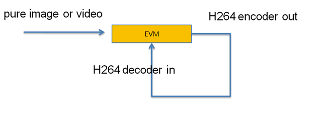

The customer wants to do H.264 DECODE/ENCODE test
Is there any test example for H264 encoder/decoder on EVM?
Is there a test case that matches the situation below for reference?

Hi Daniel,
If you are using the latest SDK release on Linux, then you can use the below GStreamer Pipeline for H.264 Encode/Decode with camera capture:
<Camera Capture -> Encode -> File>
gst-launch-1.0 -v v4l2src device=/dev/video2 io-mode=dmabuf-import num-buffers=1000 ! \
video/x-bayer, width=1920, height=1080, framerate=30/1, format=rggb10 ! \
tiovxisp sink_0::device=/dev/v4l-subdev2 sensor-name="SENSOR_SONY_IMX219_RPI" dcc-isp-file=/opt/imaging/imx219/dcc_viss_10b.bin sink_0::dcc-2a-file=/opt/imaging/imx219/dcc_2a_10b.bin format-msb=9 ! \
video/x-raw, format=NV12, width=1920, height=1080, framerate=30/1 ! \
v4l2h264enc output-io-mode=dmabuf-import ! \
filesink location=out1.264
<File -> Decode -> Display>
gst-launch-1.0 -v filesink location=out1.264 ! h264parse ! v4l2h264dec capture-io-mode=dmabuf ! kmssink driver-name=tidss
Let me know if this helps.
