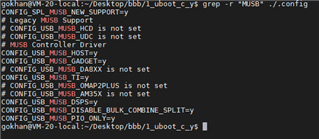

    Please attach your U-Boot .config. I'd like to check if you have all MUSB related Kconfig options enabled. The following document explains the menuconfig process for AM335x USB-Ethernet boot.

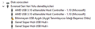

    I have work with other brands (about board bringup process). While I am working with UNIFLASH, I got confused. UNIFLASH can reach and triger board via RNDIS, It means it is writing ****.bin but cannot jump to u-boot.img.
    This  screen shoot enough?

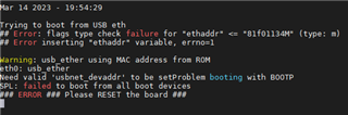

  • SPL is so closed system doesn't like u-boot. Doesn't let me to change MAC address.
    I use the config below
    (CONFIG_USBNET_DEVADDR="aa:bb:cc:dd:ee:01" )
    It still said: MAC 81f01134M
    I believe i made a progress but sill i need help. Will any body help ?

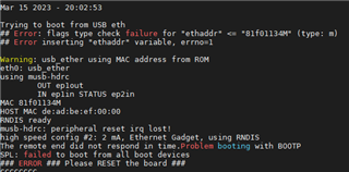

  • Hi Gokhan,
    The latest log shows the USB stack is initialized but the host fails in responding the BOOTP request. I am not sure if it is because of the MAC address error. I am routing your query to our U-Boot Ethernet expert for comments.
