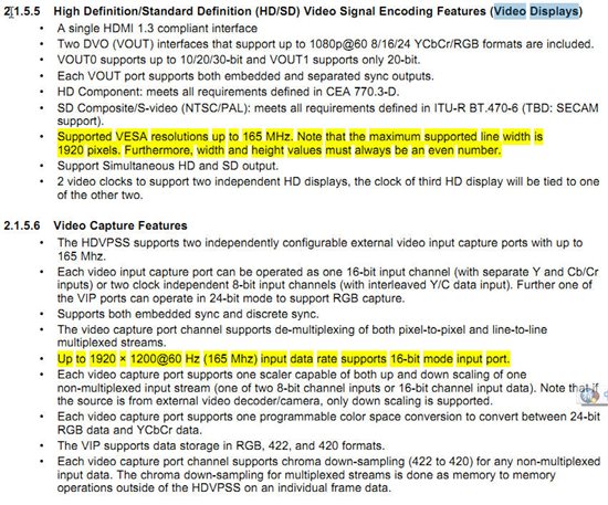

About DM8168 VPSS capture performance。
        I have  signed  NDA  and get some document of DM8168,  have not found the introduction of  VPSS capture size.  And in the datesheet of DM368, we can found the limit of ISID, just like,
      • Up to 32K pixels (image size) in both the horizontal and vertical direction
• Up to 120 MHz sensor clock
• ITU-R BT.656/1120 standard format
• YCbCr 422 format, either 8- or 16-bit with discrete H and VSYNC signals
• Up to 16-bit input
• Color space conversion
• Digital clamp with horizontal/vertical offset drift compensation
   where  can  I find  the limit of DM8168?
