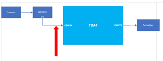

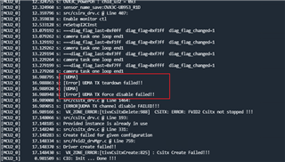

hi TI experts
In the test, we found that there is a probability that CSI TX UDMA will fail. The specific log is as follows:

 [MCU2_0]     16.474997 s: [UDMA]
 [MCU2_0]     16.475064 s: [Error] UDMA TX teardown failed!!
 [MCU2_0]     16.475154 s: [UDMA]
 [MCU2_0]     16.475182 s: [Error] UDMA TX force disable failed!!
 [MCU2_0]     16.475228 s: src/csitx_drv.c @ Line 1464:
 [MCU2_0]     16.475263 s: [ERROR]UDMA TX channel disable FAILED!!!
 [MCU2_0]     16.475311 s:  VX_ZONE_ERROR:[tivxCsitxDelete:988]  CSITX: ERROR: FVID2 Csitx not stopped !!!
 [MCU2_0]     16.632875 s: src/csitx_drv.c @ Line 193:
 [MCU2_0]     16.632943 s: Provided instance is already in use
 [MCU2_0]     16.632999 s: src/csitx_drv.c @ Line 331:
 [MCU2_0]     16.633049 s: Create failed for given configuration
 [MCU2_0]     16.633094 s: src/fvid2_drvMgr.c @ Line 759:
 [MCU2_0]     16.633182 s: Driver create failed!!
 [MCU2_0]     16.633227 s:  VX_ZONE_ERROR:[tivxCsitxCreate:825] : Csitx Create Failed!!!

The laws found in the testing process are as follows:
1. One third of PECUs have this problem at normal temperature
2. Some PECUs will not have problems at normal temperature, and this log will occur after power-on at a low temperature of -40 degrees
3. This problem rarely occurs in some PECUs under any temperature environment
Based on the above test, we currently have the following questions:
1. What causes this UDMA to fail? Have you ever had a client in this situation before?
2. What submodules will be affected if UDMA TX fails to be displayed in log? Will it break video input?
3. Why does temperature affect the probability of error?
4. Is there a quick way to locate the problem?
Best wishes
    I see error in the CSIRX driver, Is it added by you? Under what condition this print comes?
     [MCU2_0]     12.176387 s: src/csirx_drv.c @ Line 407:
    Which SDK release are you using? Typically tear down is called from Udma_chDisable API, This is typically done to stop/disable the UDMA channel and is called while stopping the driver, ie Fvid2_stop ioctl, which is called when the csitx node is deleted. So can you please why delete of this node is called? Are you deleting the graph or releasing the entire application on some error?
    Brijesh

  • Hello Brijesh,
    I would like to give you more reference information. As the below picture, we use TDA4 and UB9702.
    We test our PCBA board and summary the test results as below:
    1. TDA4 junction temperature is below 60℃. TDA4 can't output video stream.
    The register 0x4504028 is  0x00001c60 or 0x00001c20.
    2. TDA4 junction temperature is between 60℃ to 80℃. TDA4 can‘t output video stream.
    3. TDA4 junction temperature is between 60℃ to 80℃. TDA4 can output video stream.
    The register 0x4504028 is  0x00001c40.
    4. TDA4 junction temperature is above 80℃. TDA4 can output video stream.
    The register 0x4504028 is 0x00000000.
    We read the register 0x7A of 9702. It always shows no error in any temperature. But the register of TDA4 shows ECC error. Why? Do you have any suggestions about this?
    Additional, the impact of temperature on both TDA4 and 9702 may need to be considered. You can assume that the trend of change is the similar, but we did not measure the temperature of 9702 separately.

  • Hi Brijesh
    We have some information to add about UDMA TX teardown failed: If output image data to Graph node before de-initializing, then de-initializing Cis-Tx, there will be no uDMA de-initializing failure.
    Qibin
  • Hi Brijesh,
    Do I just need to update this patch to sdk/rtos/pdk_jacinto_07_03_00_29? Does sdk/qnx/psdkqa/pdk need to be updated?
    Qibin
  • Hi Qibin,
    This patch is for RTOS PDK driver, so just need to update it in rtos/pdk_jacinto_07_03_00_29.
    Brijesh
  • Hi Brijesh,
    This patch still doesn't solve the current problem, which is supposed to be caused by something else. Did you find anything new on the registers dumped yesterday?
    Qibin
  • Hi Qibin,
    ok, then, i really doubt we can do anything from SW. DPHY just reports the ECC errors that it detects from the incoming stream.. So need to see why lanes are getting affected.
    It seems that issue is coming from HW.
    Brijesh

  • Please note, as Brijesh mentions above, after the exchange so far, he doesn't believe this is a SW issue; therefore, per his request, I am involving the HW apps team at this time.
    John
  • As part of the HW apps team, can you please send the latest schematic and layout files?  We have some from a couple years ago, but those are likely outdated by this point.
    John
    This topic can be closed. We have found the root cause from UB9702's side.
    Many thanks!
  • Hi An,
    Could you please help us to understand what's changed in UB9702 to help in this issue?
    Brijesh
  • Thanks An, closing this ticket.
