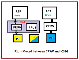

  • Thanks Dekel,
    I am following below steps to reproduce the issue:
    Assumption:
    • R5F (RTOS) and A53 (Linux) both are not trying to access ICSSG as this is not a supported feature in SDK.
    • R5F (RTOS) and A53 (Linux) both are not trying to access CPSW as this is not a supported feature in SDK.
    Using baseline: https://www.ti.com/tool/download/MCU-PLUS-SDK-AM64X/08.02.00.31
    1. Start "enet_lwip_icssg example" on R5F_0_0 to starts communication with ICSGG port.
      1. Then start "ipc_rpmsg_echo_linux" on A53
      2. Should get "a failure from EnetMcm_open due to DMA open failure"
    or
    1. start "ipc_rpmsg_echo_linux" on A53
      1. Then, start "enet_lwip_icssg example" on R5F_0_0 to starts communication with ICSGG port.
    Note: We have fixes for DMA channels sharing (among cores) related issue in SDK 8.3 and onwards. So, It will be a help you can try SDK 8.5 on your side.
    Best Regards
    Ashwani

    From the DTS it seems that ICSSG is disabled, but CPSW is still enabled in Linux.
    We currently don't have any applications that use it, but there might be some system drivers / packages that utilize it.
    From what I understood from Nick:
    There are two kinds of Ethernet peripherals on the AM64x: The CPSW (which can have 2 external Ethernet ports), and the PRU Ethernet (Each PRU_ICSSG can have 2 external Ethernet ports, and there are 2 PRU_ICSSGs in the processor).
    And the changes we have made for AM64x GP-EVM device tree are:
    Linux is using 2 CPSW ports.
    Linux will disable 1 PRU Ethernet port, and that port will be used by R5f core.
    Here is the DTS patch file i am using, it may be easier to read than the entire DTS:

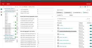

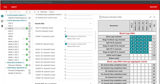

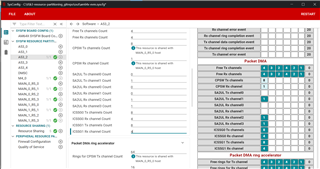

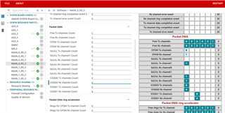

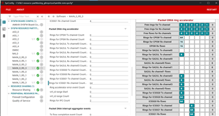

    3) any updates to the DMA settings?
    Did you make any updates based on Anil's suggestions above? (note, he might have linked to the steps for updating Linux SDK SPL instead of MCU+ SDK SBL since that discussion was before the boot flow was clarified)
    In terms of setting the proper host ID to send the DMA interrupts to:
    A53_2 - Linux
    MAIN_0_R5_1 R5F subsystem 0 core 0
    MAIN_0_R5_3 R5F subsystem 0 core 1
    MAIN_1_R5_1 R5F subsystem 1 core 0
    MAIN_1_R5_3 R5F subsystem 1 core 1
    Nick
  • Hi Nick,
    Regarding to the questions above -
    Boot flow confirmation - please respond
    Yes, we're using SBL EMMC Linux
    On last week I had a debug session with Prashant and we made the configuration blob according to the instructions above (using MAIN_0_R5_1).
    We used the BIN file as part of the secondary bootloader but I get the same error from EnetMcm_open as I received before.
    Dekel
  • Ok, so to summarize:
    Linux A53 is using both CPSW ports

      Customer usecase
      * AM64x on SDK 8.2 (will need to be updated at a later date)
      * SBL boot, booting Linux on A53 (SBL EMMC Linux)
      * Linux A53 controls both CPSW ports
      * An unknown R5F core is using ICSSG1 for PRU Ethernet

      First, look at the Linux settings under A53_2. Let's look at Packet DMA:
      See how Linux is the one using ICSSG1 TX channels? We need to change that.
      Go to the 3 dots in the upper right corner. Select "Resource Allocation Table". Click the two arrows in the Resource Allocation table to expand it. You should be able to see something like this:
      If I scroll down on the resource allocation table, I can see that all of the ICSSG1 packet DMAs are allocated to Linux:
      Let's change that. I'll set "ICSSG1 Tx channels Count" and "ICSSG1 Rx channels Count" to 0 for A53_2, and set them to 8 and 4, respectively, for MAIN_0_R5_3.
      Now we see the changes in the resource allocation table:
      However, if we scroll down, we'll see that the Packet DMA ring accelerator is still sending ICSSG1 rings to Linux:
      Let's change that as well:
      5) Grab the output file and place it in the MCU+ SDK
      Once you're done, close the resource allocation table. In the "Generated Files" section, you can see the "sciclient_defaultBoardcfg_rm_mcusdk.c" file.
      In your MCU+ SDK, I would rename source/drivers/sciclient/sciclient_default_boardcfg/am64x_am243x/sciclient_defaultBoardcfg_rm_linux.c to something like sciclient_defaultBoardcfg_rm_linux.c.orig. Then copy the "sciclient_defaultBoardcfg_rm_mcusdk.c" file and rename it to sciclient_defaultBoardcfg_rm_linux.c.
